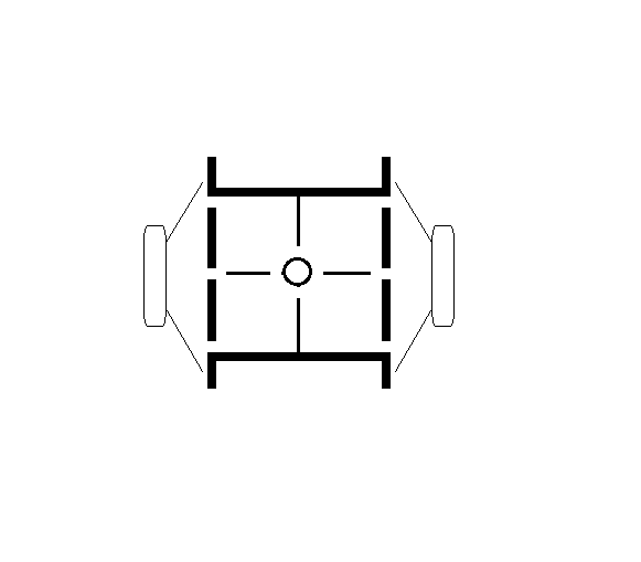

I concede that those measurements of the SH50 look really good. Clearly better than the VTC EL210.
One limitation that I'm living with is a depth of about 40cm. My Summas are close to 50cm wide, and that's just waaaay too big. I can't afford to have speakers that are that imposing.
Using a depth of 40cm, here's how much Synergy horn could be squeezed into that footprint. It has the following features:
1) horizontal coverage of fifty degrees, basically because it's a good compromise between directivity and extension of the midranges
2) Width and depth of 40cm. (Basically so you can cross-fire it, like Geddes recommends with the Summas)
3) Four 5" mids (PDMR5) and a Dayton D250P at the apex
The big downside with this configuration is the mouth size; due to the size of the compression driver and the size of the cabinet, the mouth is about 15cm across before it terminates into the baffle. That equates to directivity control down to 2300hz. So basically the horn doesn't provide any pattern control for the mids, in fact it doesn't even control the compression driver beyond 2300hz.
Sure, a big horn would do a lot better, but I simply don't have space for one.
In my next post I'll see what a Paraline can do.

Thanks for the VTC graph PB. I was trying to find one yesterday but couldn't. I'd hope their manufactured Paralines would measure better than mine! Much tighter tolerances I'm sure. If you were to scale it similar to mine (or mine to theirs) I don't think it's really all that much worse though. The CD I was using there was the little 4524.
To me there's something distorting the waveform (giving the non-flat response other than the usual CD horn fall off), and I would say the obvious cause here is the device itself. When I built these I thought "eq can fix it." And it can........to a point.
Lately I've been reading up on Geddes' ideas, his patents and other articles. A lot of it's still pretty Greek to me, but then there's a lot that seems quite logical. Getting sound from the driver without diffraction, HOM, and with controlled directivity sounds
pretty key to me. I would think that a regular Synergy/Unity horn can do this much better than any kind of Paraline variation. I would think a guy that owns a set of Summas would be working toward this goal. A Paraline just adds a lot of unnecessary complications for home use IMO.
If space is that much of a concern, maybe just stick with your little Kef egg speaker deals? I think trying to squash a Synergy design down kind of misses the point. If size is more important than directivity to you, I could see a 10" tall Paraline with the mids mounted in the device itself like I have. You'd have the eff and dynamics of a big speaker, just no pattern control.
