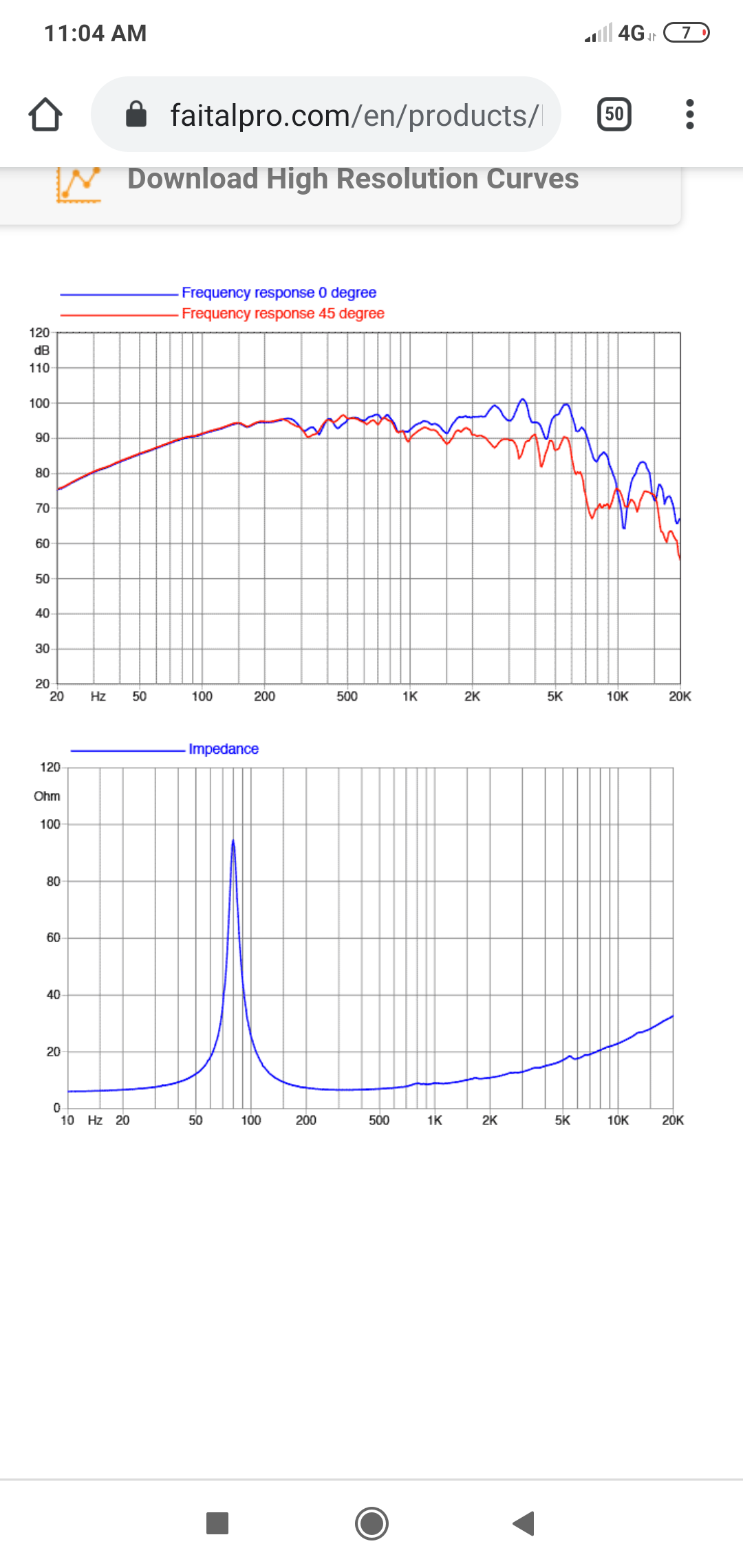

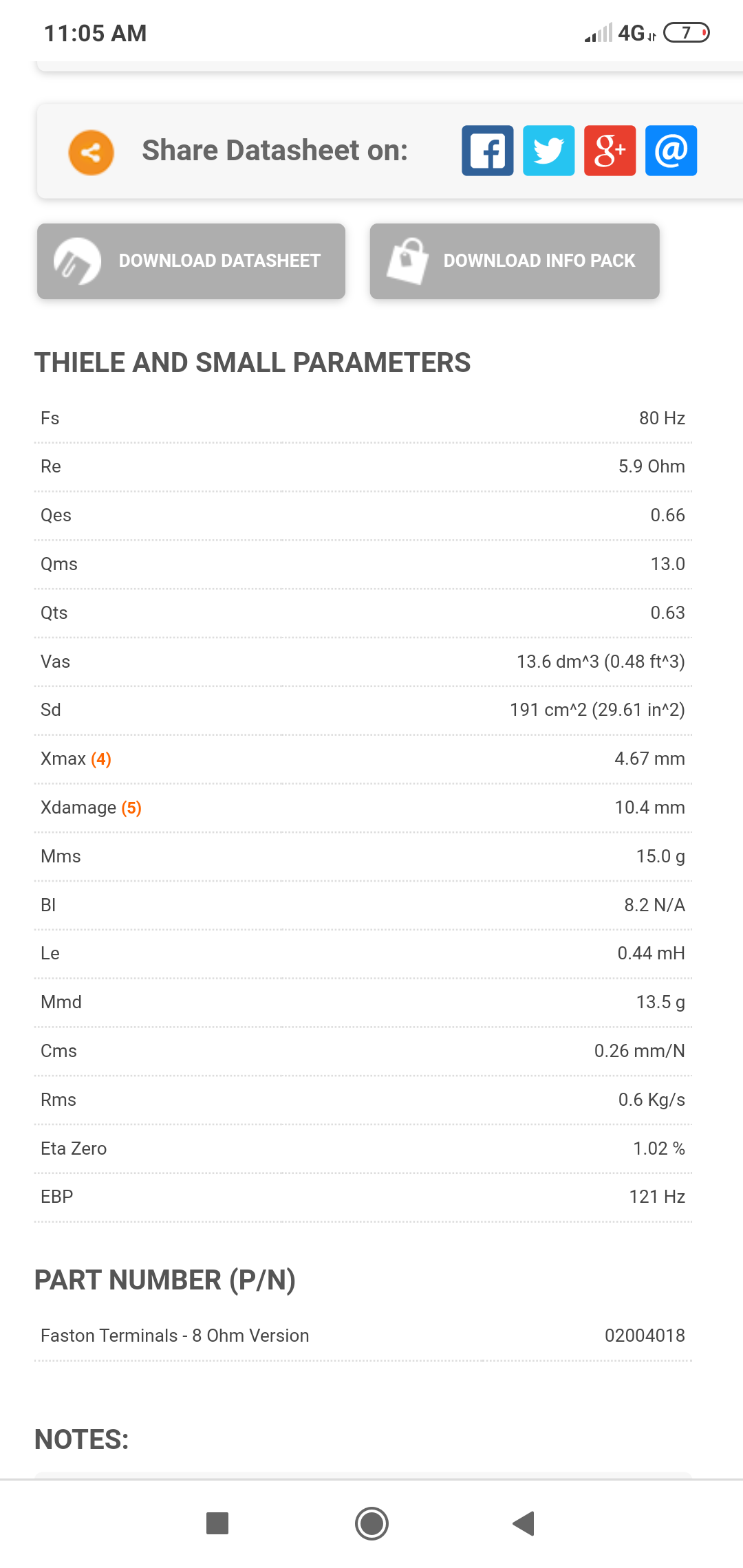

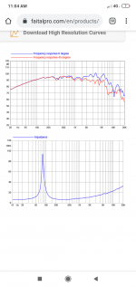

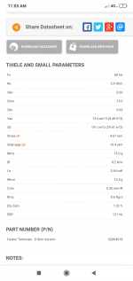

Qts=0.63
Vas= 0.48 cubic ft
Please see the attached TS parameters

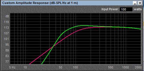

please see the basic simulation graph attached.
Pink graph:
12L sealed box.
F3 = 117hz
F6 = 90hz
Green graph:
20L PORTED box.
Box tuning = 65hz
F3=64hz
F6=55hz
(there is a peak which has to be flattened further-im trying)
I know simulation doesn't exactly replicate real life performance.
I have to learn how to calculate MLTL and TQWT. I will work on it.
But meanwhile, based on your experience, what can be the advantage with MLTL or TQWT compared to sealed or ported. Any suggestion please ....

You have to see if a standard port is feasible for your design. The port air velocity is very important. Model the port at your desired power use and see the speed. Speeds over 30 are bad since they generate chafing aka bad port noise. About 15 are good. So you model your port and tune and power: that will tell you the diameter, length and number of ports required for your goals. Doubling the ports halves the speed but each port will be twice as long. Sometimes a port for the desired power output and speed cannot be physically built on the cabinet. At such time look for other type of box architecture.
