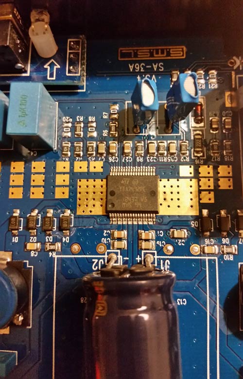

When I received it, the back voltage markings were suspicious (12-15v instead of 12-24v), so I opened it up and here's what I saw: not a tpa3116/3118 but instead a TDA7492PE chip! And seams to be under-powered. I've ordered 3 now from 3 different sellers: Amazon ships and sold by, CrazyEve/Amazon, and an ebay seller sourced in China that seemed legit and shipped very fast (US warehouse probably). The latter is the one I have now. It's strange because the board is printed with sa-36a (not pro) and its NOT using the older ta2020 tripath chip.
What do you think? Is this counterfeit, or SMSL changing the build? How would it measure up against the 2014 2.1 and 2.2 versions of sa-36a pro?
This build looks like a downgrade to me, but I don't know anything, I'm looking for some wordly input from those in the know here. Thanks

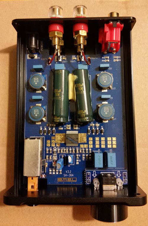

2 different units opened up here with slightly different builds.

The one I still have is the first pic with the single capacitor. Would you still recommend a pair of the NCC KZH 2200uF to replace the single? Or something else?
Also from what I've read I thought a heat sink was recommended for the tda7492. Based on what you can see on the board is it worth modding this?
The one I still have is the first pic with the single capacitor. Would you still recommend a pair of the NCC KZH 2200uF to replace the single ?
Yes - if they fit, put them in. Can't have too many caps
From what I can see in the DS the chip has an exposed pad on the underside. There looks to be some kind of heat spreader built into the PCB which connects thermally to that pad. So I think you're probably fine.

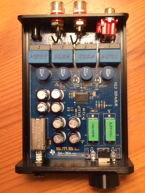

Genuine TPA3118 36A Pro
Ok, I killed the holographic anti-tamper warranty void sticker opening this up but I had to find out if I got a fake 3118. I guess I did ok as it is the 3118 layout and chip says 3118, although doesn't say "TI". I noticed that the C45 and C46 caps are empty - do these normally come with something there like OSCON's or is that typically an upgrade people do themselves? As long as I have it open should I go ahead and solder a couple of Panasonic SEPF 330uF 25V's in place?
I forgot this amp has bootstrap snubbers - can clearly see the 10R resistors and caps connected to main output traces.
Note that mine is v2.2 dated 2014/6/6 whereas the TDA variants are v3.1 and v3.2 as shown in Post #1. I bought mine last October from Amazon.
xrk971 there a some posts from the mega thread TPA3116D2 Amp that show variants of the 2.2 layout:
http://www.diyaudio.com/forums/class-d/237086-tpa3116d2-amp-394.html#post3994924
http://www.diyaudio.com/forums/class-d/237086-tpa3116d2-amp-454.html#post4032149
- you seem to have some differences, these two links show the c45,46 caps already there, different filter caps. But it's a lot closer to what's expected than what I got...
The sa-36a pro is starting to look like a box a chocolates.....

Looks like the simply left off the caps C45 and C46 to save money. Then later realized no one noticed and said, let's swap out the 3118 for the 7492, no one will notice and no will bother because we have such a good reputation already (thanks to xrk on DIYA). And if we stick a fancy do not remove or void warranty sticker on it, that will deter another 95% of the people from ever opening it to check.
This could actually be a class action if they purposely have been misleading the buyer (and even the reseller). You would have to purposely do it because the TDA7492 is a completely different amp.
The open c45c46 has been noticed by several buyers and mentioned in multiple threads multiple times. SMSL is selling you SA36aPRO, changes to specifications and parts can occur without prior notice, you know, it is the beauty of branding we like. You read a review of Macbookpro and screen is fabulous, then you buy same typenumber and screen is flawed, you go to Apple service point and they say, yes now it is eg Samsung screen, it used to be eg LG screen and the new screen is up to spec
