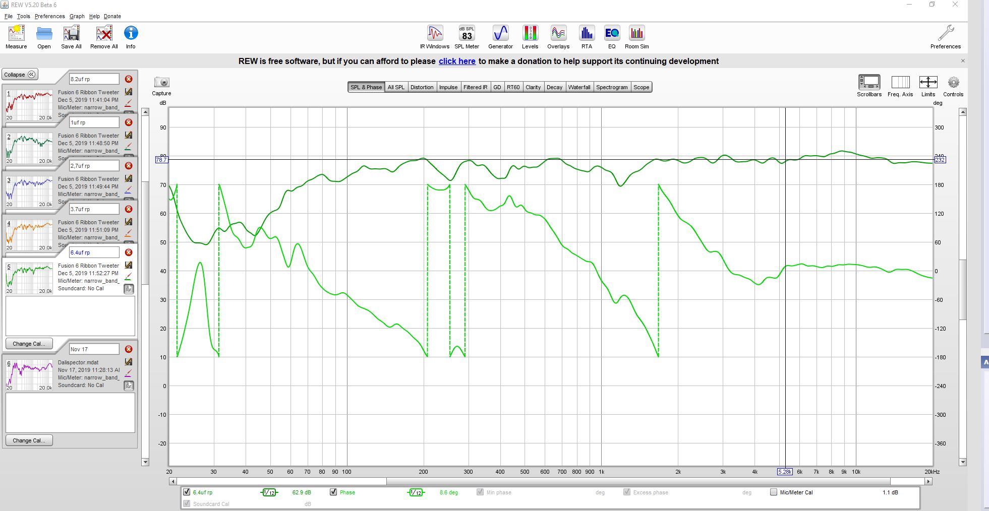

Yes, I am using REW and a miniDSP UMIK.
I now switched from the compression driver to a ribbon tweeter that I had around, just for sake of testing.
Here is a measurement at 1 feet on axis (in front of the tweeter) 1/12 smoothed, i had to upper the tweeter cap to 6.4uf and put the 8ohm L-Pad resistor from PE at the max setting (reverse polarity measured better).
This seemed to measure flatter and it does sound good, maybe not as edgy and aggressive as the CD (with the modified cap and resistor), but more neutral and mellow, but still able to hear small stuff in movies.
The thing is that I can get rid of the dip at around 1500hz, but that's not tweeter problem, but woofer, correct? Maybe I need to start messing with the woofers XO (this is a MTM horizontal positioned central speaker). I will tray off axis measurement and in different positions.
Here is the measurement.

...and one more thing. can you in your fr response go to controls (upper right corner) and unwrap the phase? it will be much easier to see what is going on with phase
have you tried to measure with the tweeter in phase/out of phase and compare?
sometimes what we predict is different from what we measure
maybe the dip is the results of phase mismatch
...and one more thing. can you in your fr response go to controls (upper right corner) and unwrap the phase? it will be much easier to see what is going on with phave
