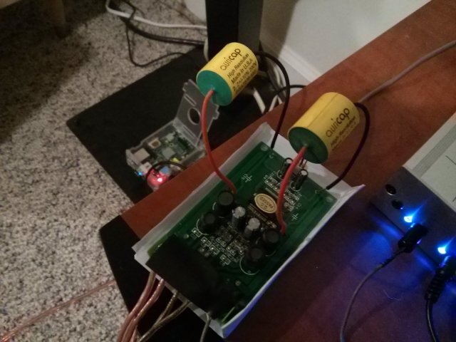

Looking for suggestions on how to modify the TA2024 amp. I've replaced the input caps with some rated at 2.2uf and it's sounds really good, but maybe a little lost in the highs overall.
Any other mods for this amp? Power caps? thank you for your suggestions!

Someone will tell me if I'm wrong but the small caps by the input terminal are input caps too (wired in parallel with your new ones )
Since they are in the signal path too and not good quality I would be removing them if I was you.

I'm not saying that all the mods will make a difference or are necessary, but that's yours to decide.
Long leads and class D!!! Added inductance, same with replacing SMD caps with leaded devices added inductance = added noise.
Ragga, is that C17 and C26? I can just remove them.
OpterN, thank you for the links. It looks like C18 and C19 power caps can be upgraded.
Marce, I will cut the leads down when I put the amp in a case. just testing now.

I have replaced all 4 output inductors with torroid type. I bought some blue/green 3/4" (o.d.) torroids and made them 10uH torroid by winding 17 turns of AWG#18 magnet wire. I can immediately tell a difference after the swap.
