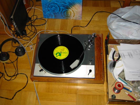

I was given an old Lenco L75 by a friend at work. It had been collecting dust for some 20 years,
but now I am thinking that I will try to put it back to service. It seems to be working and all
the weights are there except for the 1 gram for antiskating.
My problem is that the stylus is broken. So now I would like some advice for a new cartridge that
would be suitable to this model. Or maybe I just should let it continue to gather dust and die in silence.
Any advice as for what to to with this TT would will be seriosly considered (even such suggestion as throwing
it in front of a train or dip it in gold paint and hang it on the wall). Of course suggestions involving some DIY will get higher ratings.
TIA Keld
PS I have promised myself that if I ever use it for music my friend will recieve a case of beer.

Hoi Keld. I had the same happen to me and revived it for 78rpm use. There is a thread here about it.
First you should check the bearings of the arm. Grip it gently and try to rock it back and forth, then try to turn it around the long axis. There should not be much play. Problem are the rubber blocks that are used a bearing for the arm. If okay, proceed, else get replaced.
Other thing to check is the drive wheel beneath the platter. Pull off the platter and check if it is still round. If left engaged for years it can become dented.
As for a cartridge, I put a Stanton hifi680 (with extra 78rpm needle) on it. Fits nicely and affordable at about 100 euro. Otherwise, take the shell like you have it on your pic and go with it to a shop, they may have a replacement stylus.

I have checked out the arm bearings and they seem a little worn.
As for the drive wheel it appears to be in good condition but I guess I will have to play a record to know for shure. I had to shorten the spring that holds the wheel a little to get the speed right.
About the Stanton needle I will look into that But the problem is where I live we dont have any decent HiFi-stores left. All have been replaced with chain? stores where the salescrew just as well could be selling vacuumcleaners at your doorstepp, and I dont even think they sell TT's.
If i went in there and showed them the headshell they would think I came from some planet far away and the thing I was showing them was some component from my flying saucer "No we stopped selling those years ago, there were no demand for them" and then try to sell me some BIG speakers "just like the ones I have at home".
So it seems like mailorder is my only option.

Anyways,for cartridge replacement the Stanton work fine,Pickering,Empire and Shure as well.
It seems to be working and all the weight are there except
Yep,that's the first one to get lost with these Lencos.
With a bit of frugalphile (TM) imagination and, as you say yourself, it is one gram a bit of fine fishing line and a one gram counterweight made out of metal can be made easily.
