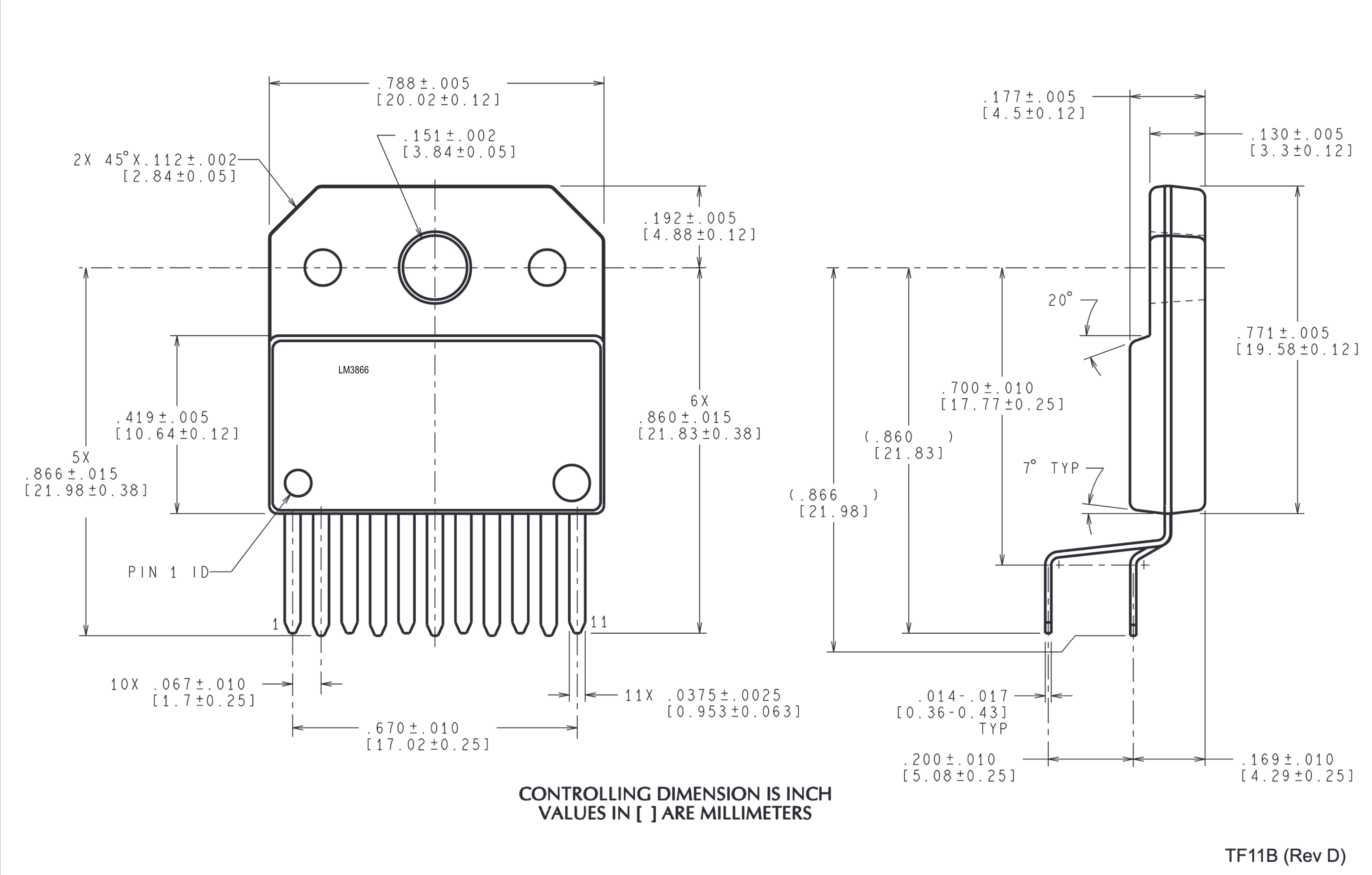

Reading a datasheet for LM3886 integrated amplifier, I found the pins span at most 2.7cm, but when I received the actual chip, this was around 2cm. Since, I have the PCB readily etched, I would like to know what other did in circumstances like these. One drastic solution is to create another PCB, but I am trying to avoid having to do that. Another one, seems to be, creating a chip footprint adapter, but this requires further etching.

In my experience parts ordering is next-day delivery, pcbs are 2 or 3 weeks. Order the parts before placing the pcb order, print out the pcb lifesize and check all the footprints _before_ placing the pcb order. Hey, you can even breadboard the circuit or parts of it to check it works too
Also ... It seems like spinning up an "adapter" PCB will create more issues (and is still a bodge)I'm sure a little re-shaping of the pins would solve the issue.
They are, after all, flexible enough.

This laterally inverted PCB with too big footprints for this chips can be used provided I create an adaptor PCB. The latter has to also provide for chip lateral inversion. I designed one already but I omitted pins marked as NC.
Yep! I do that on all boards that use a new footprint. I usually print out the PCB top layer 1:1 and put the paper on a piece of ESD foam. I then align the part with the footprint and push the pins through the paper and into the foam. I also double-check the dimensions of the pins with the hole dimensions in the layout software.

I also discovered the PCB layout is laterally inverted.
Oops. Yeah. You have to be careful with "top view" vs "bottom view" when reading data sheets.
For a one-off prototype, bending the pins to make it match the footprint works well enough. An inverted board would make me grumble, kick myself, and go etch another board.

I also discovered the PCB layout is laterally inverted....
Put the chip on the back side.

Since locally available blank PCBs are very very low quality, I had to be contented with the inverted PCB, which has IC footprints almost twice as big as needed. To work around the huge footprint real estate and the pin lateral inversion, I designed two small PCBs to hold the chips and to flip the connections. Many parts of the circuit are now assembled. The chips, the large power supply decoupling capacitors, the negative feedback chains and the input filters are installed except the input capacitors. This allowed me to do the first testing of the circuit with a weak power supply that can provide a few hundreds of milliamps. The rail voltages remained at 12V and the DC offset voltages were around 1.5mV and 3.5mV. This means, the inversion was successful and the chips are working.
