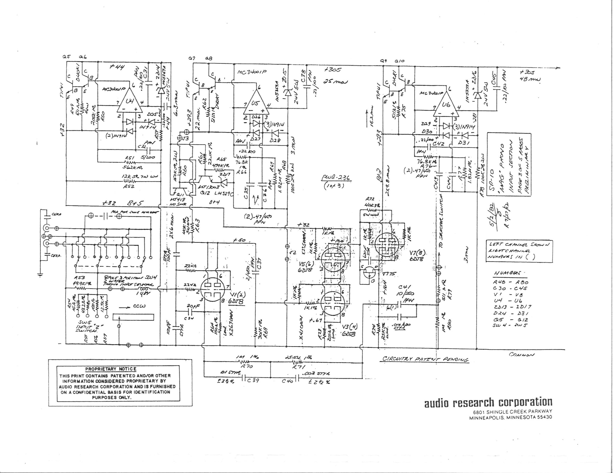

They've got eight tubes, four per channel, in the phono stage of the SP-10, plus another four in the high-level stage! What are they doing with all these tubes? The only other phono stage I've seen that uses eight tubes is the Aikido design (http://glass-ware.store.turbify.net/ph2.html), which says in the notes that it uses one gain stage before the RIAA network, and another after, to account for the insertion loss of the RIAA network. Is Audio Research doing something similar? How do other designs with less tubes handle this?

Each dual triode has its two sections in parallel.
The second stage is a cascode, followed by a cathode follower.
It's the usual ARC topology, with the cascode added.
For some reason they use two triodes in parallel everywhere. It might make sense in the input stage to reduce the equivalent input noise voltage, and maybe in the output stage to increase the maximum output current, but why they do it everywhere is unclear to me.
Otherwise it's just a configuration that's used all over the place in solid-state circuits: input stage, common-cathode/-emitter stage (which Douglas Self would call the VAS), voltage follower stage. You don't see it made with valves very often, but there is no reason why that wouldn't work. The only thing that's missing is the usual Miller compensation, apparently they got it stable without that.

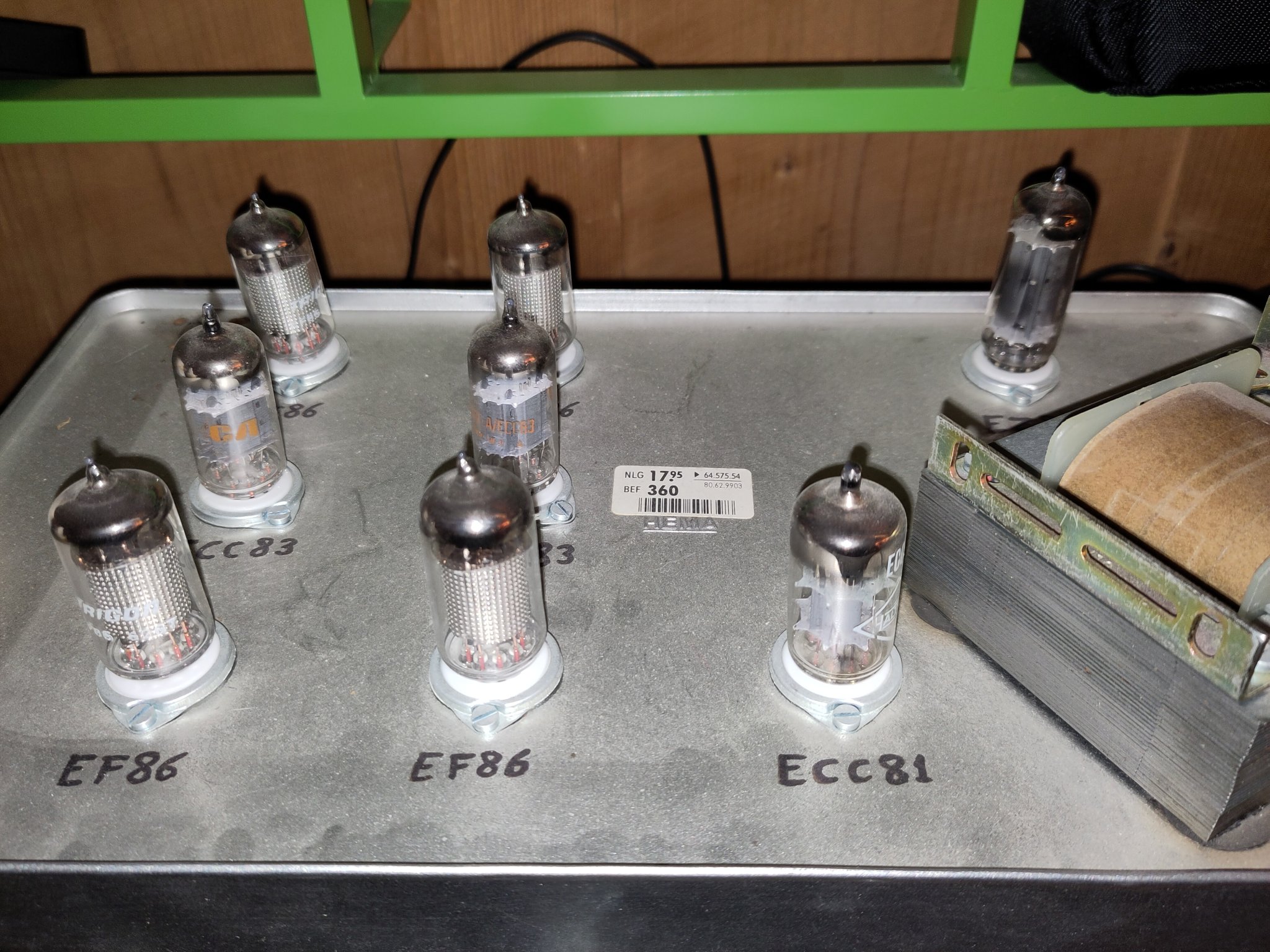

I also use eight valves in my phono preamplifier, by the way, but that's including power supply rectification and output relay control.

Two gain stages and a follower, classic since the days of McIntosh and Marantz, with long loop RIAA feedback. Worked well then, still works. Today, ideal RC values (with bogey valve assumptions) are easy enough for the motivated. I'd argue that the topo, with practical valves, even ECC83s, is close enough to ideal that it cannot be improved upon. Many would disagree, but it would be contentious.
The really interesting discussion is about an RIAA amplifier of an ECC83 per channel without follower, as in so many classic era (H.H. Scott, Dyna, Eico, Fisher, etc.) amplifiers. IMHO, of course.
