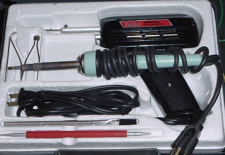

I've been thinking of making up my own cables (I have some designs in mind).Havent done much soldering before thought, but will practise first.
What type of soldering Iron , solder and over stuff will I heed?😀

I use a 35W Weller soldering iron
and a 100W Weller soldering gun for big jobs 🙂
I use different solder depending on the project and the money I want to put on.

What is the model of that 35W Weller iron in the picture? I am prone to getting irons that either don't perform well or have tips that corrode too quickly (e.g. the one sold at PartsExpress.com for $15 with ceramic heating element - they don't even carry the replacement tip for it anymore!).

WP25, sorry it is a 25W. Cheap and still working. I prefer spending more money on my woodworking tool 🙂
