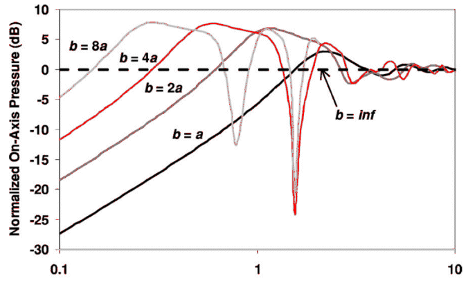

If baffle width "b" becomes large compared to cone diameter "a", a hump with a following dip will develop in the response:
(Fig.5 from Mellow/Kärkkäinen "On the soundfield of an oscillating disk ...")
http://www.mellowacoustics.com/articles/Disk_in_a_circular_baffle.pdf
So just be prepared to equalize that dipole hump.
Rudolf
