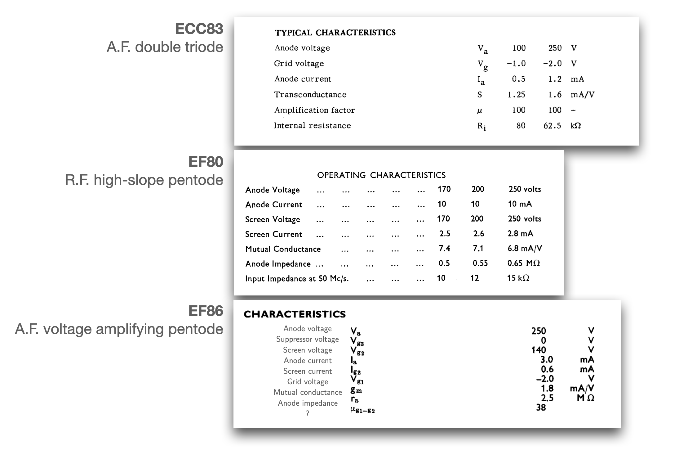

In the attachment I am comparing ECC83 with EF80 and EF86.
I see that the "non-audio" tube here (the EF80) has higher current on the anode and much larger current swing for a given change in grid voltage (the mutual conductance).
Why do the "audio" tubes prefer a lower mutual conductance? Or maybe I'm generalising too much.
What are the characteristics of a "good" pre-amp valve for a guitar amp and why?
- The anode voltages are all similar ~250V
- The grid voltage ranges are similar
- ECC83 and EF86 have lower plate current
- The EF86 has much lower (x6 smaller) mutual conductance than the EF80
- The EF80 has much high screen and voltage and currents and much lower anode impedance than the EF86

.....the "non-audio" tube here (the EF80) has higher current on the anode and much larger current swing for a given change in grid voltage (the mutual conductance).....
RF (radio) circuits (with coil loading) can run HIGH currents. 10mA.
Audio circuits with resistor loading usually run lower current. 1mA.
Gm rises with current. About as square root. So expect a 10mA tube to show about 3X the Gm of a 1mA tube. Pretty much even if they are the same tube under different bias.

PRR, why do audio tubes tend to have lower currents? Is it because for audio (at least in the preamp) one wants voltage amplification rather than current amplification? But… can’t we just use the load resistor to “convert” the large current swing to a large voltage swing?
IF there is in fact a large resistor. There are capacitances hanging off of everything, and at RF they can dominate the impedance. You can resonate them out, but the Q of the tank will only let you get the impedance so high. If the working impedances are low, you want high current tubes. At audio where a few pF of capacitance won’t bother anything, you can have 100k or higher plate resistors so low currents work well. High resistances also generate more noise than low ones, so in very low noise situations the currents will creep up, even at audio. Guitar amps tend not be be concerned with noise as much as gain, so you’ll see lower currents and larger resistors than even in hi-if.
P=UI. Power of a component is physically limited. So if you have a big V you can have a low I and the opposite.
V of valve is high so current is low @ P = constant
P=10W :
If V = 250V then I = 40mA
If V = 20V then I = 2A
So for the same output power a valve need less current than a BJT or AOP because voltage is bigger.

And as the current is more little, you need bigger resistors to have the voltage drop necessary for your circuit 😉
Thanks WG and Kartapus,
This really made things click. I will try and summaries what you said so check my understanding.
At radio frequency the capacitance of the tube can dominate the circuit. This can be mitigated by using lower value resistors, which means that currents will naturally increase because I=V/R. Moreover, if R goes down then I goes up.
At audio frequency the capacitance of tubes are not really a problem so it's possible to use lower currents. Lower current tubes require higher resistance values for setting the bias. However, high resistance increase noise in the circuit, but for guitar amplifiers this is generally not much of problem.
So the reason ECC83 tends to be used in guitar amps is that it gives the most amount of gain (mu=100 for that tube), acceptable frequency response and introduces acceptable noise, and because the current is low the power rating of the components can be less.
I hope I followed!
ECC83 is the highest gain of the commonly available “preamp” tubes. To get higher gain in a single stage you have to resort to using pentodes. That results in a far different distortion profile. Many are horribly microphonic - not what you want in an amplifier with a built-in speaker. And they use more power in general - higher plate and heater currents, and wasting some in the screen. Sometimes you do want that much gain, especially if feedback is used to linearize things and keep them quiet. But thats not the typical way to design a guitar amp.
70 mu triodes often do provide sufficient gain, especially if 5 stages are used instead of 4, for instance. Depending on the circuit it may be a wash with the 100 mu since that isn’t the only factor involved.
