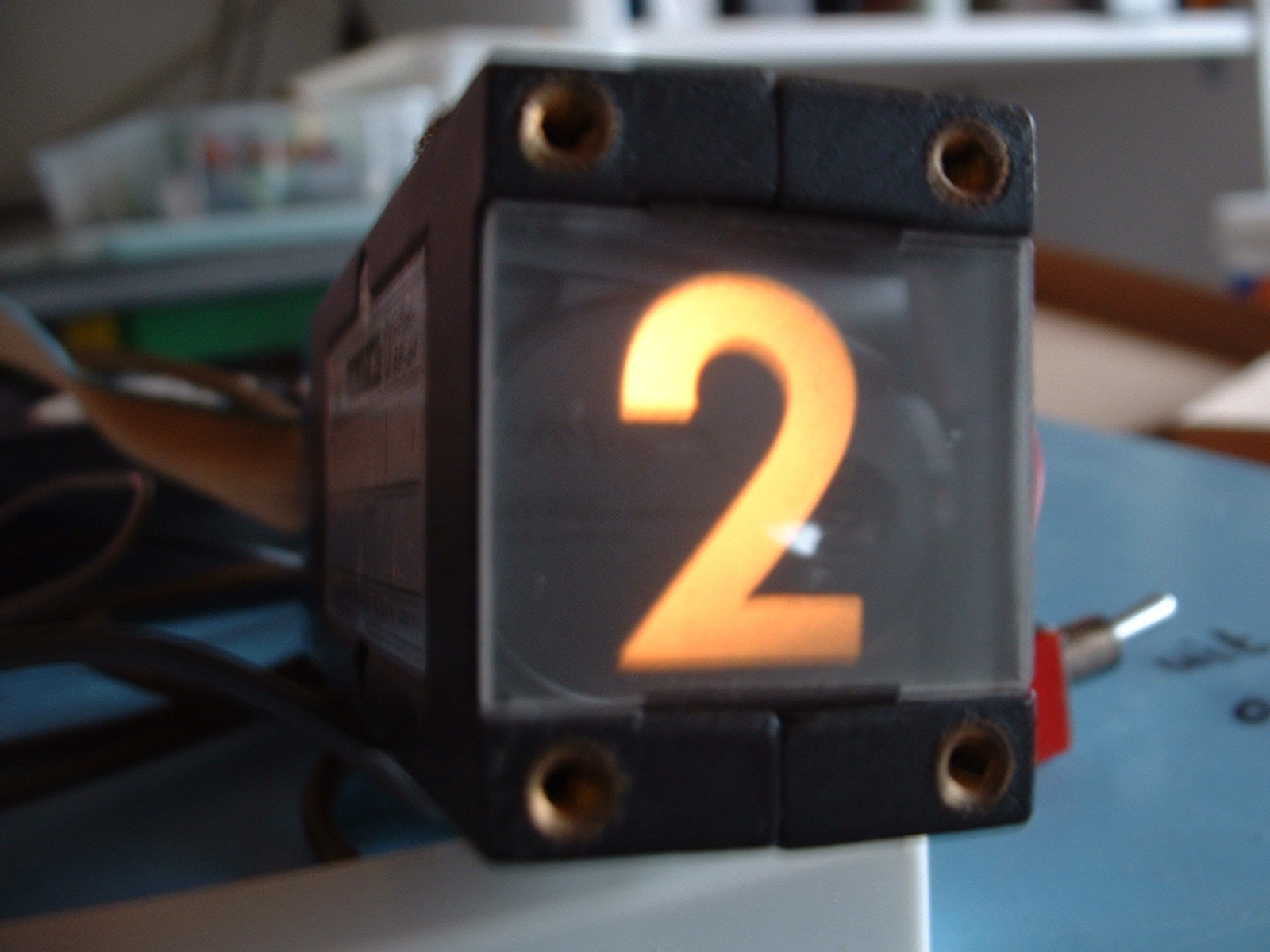

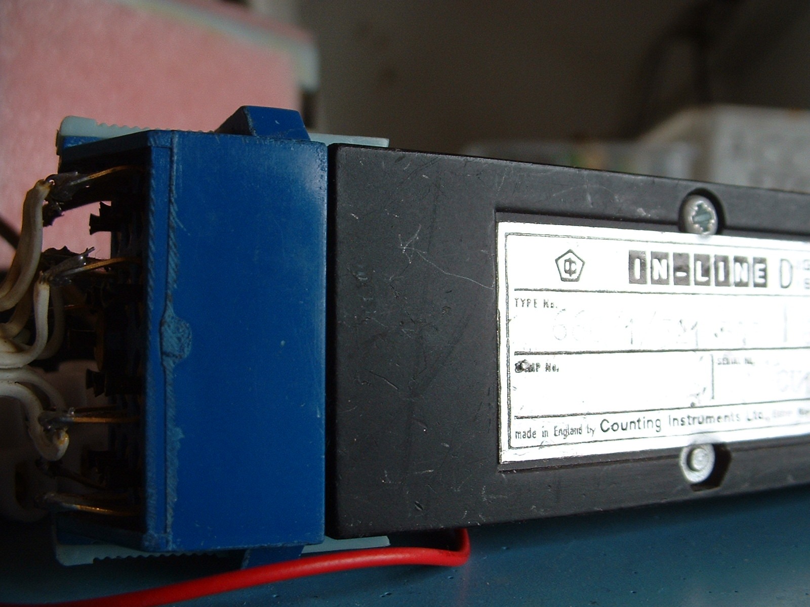

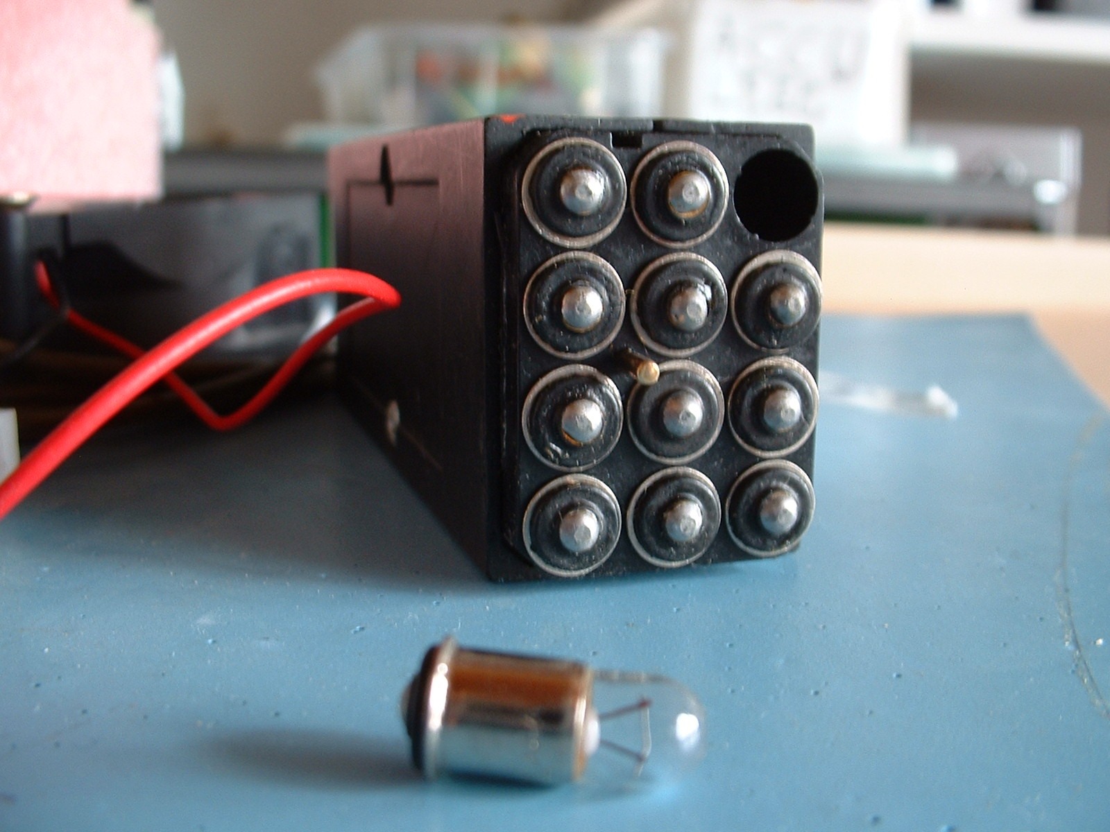

Here's a lesser known numerical display technology which may fit the bill:
A numeric display which used tiny bulbs (1N4001 diode sized) and had black and clear plastic cutouts for each digit, so that the digits appeared as if they had been produced on a typewriter, i.e., perfectly formed.
I read it here: https://www.eevblog.com/forum/chat/...lisle-st-tottenham-ct-rd-in-their-prime-(uk)/
You mention rotating cylinders, so presumably the bulbs would remain fixed and the plastic cutouts would rotate.
I used to have some of those old plastic and bulb displays - kick myself for no longer having them. They worked like a Nixie in that there were no moving parts and each character was at a different depth from the front of the display. No, the images I posted are not of this type. The digits are always at the same depth regardless of whether it's a '1' or a '9'.
It's not a flip chart type either because there are no horizontal lines across the numbers.
I saw a video of one working, just can't find it right now but will post it later if/when I do. The numbers changed very rapidly and the video was from the 60's so the mechanism was not obvious but a quickly rotating cylinder would work.
We're not there yet!
A type of display used ten tiny slide-like projectors behind a frosted glass screen. It was clever: the lenses corrected the geometrical aberrations caused by the juxtaposition of each projector, and the result was very satisfactory visually: good contrast, luminosity, nice font types, etc.
It was rather bulky though, and used ten incandescent light bulbs as sources
