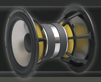

I want to understand the "Dual force canceling subwoofers" they speak of... What is the principle? Is it some severe thing or something as simple as reversing the phase of one of the two subwoofer signals?

The drivers are acoustically in phase (as they move out, they pressurise the room), but mechanically, they move in opposite directions.

Imagine a subwoofer with a huge super heavy 18" cone on the front.
Sir Isaac Newton told us that for every action there is an equal and opposite reaction.
Therefore, as the cone moves in and out, the cabinet must rock back and forth slightly to compensate. This generates slight acoustic vibration into the air and probably into the floor.
Now if you mounted an identical cone on the back, with the same polarity, the mechanical motions cancel. When both cones move in or out, there is no net momentum and the cabinet won't rock (at least not due to the cone motion).

If you mechanically link the two opposite drivers you can decouple
the driver mountings from the cabinet without any real effect.
This is the ideal way of doing it, reducing direct cabinet vibration.

Which is exactly what Thomas Barefoot did here.
Also call push-push. Mechanical linkage is important... some commercial designs that use the enclosure as the linkage miss the point.
KEF can possibly be credited with the 1st commercial implementations.
This concept shows an extreme implentation including a specially executed woofer.

Whenever possible i use this technique as it can remove a very significant amount of energy from the box, dramatically reducing boxiness and the likelihood of resonance excitation.

Is such a driver combination available to DIY folks or is it some aftermarket proprietary thing? How are those two drivers attached to each other?
I't pretty much has to be just 2 drivers with a metal ring that fits perfectly over the end plates...
Install one driver (from the outside). Slip the ring over the backplate. Install the other woofer and slide its back plate into the ring. Since there is a big hole where the plate amp fits you can guide it manually
