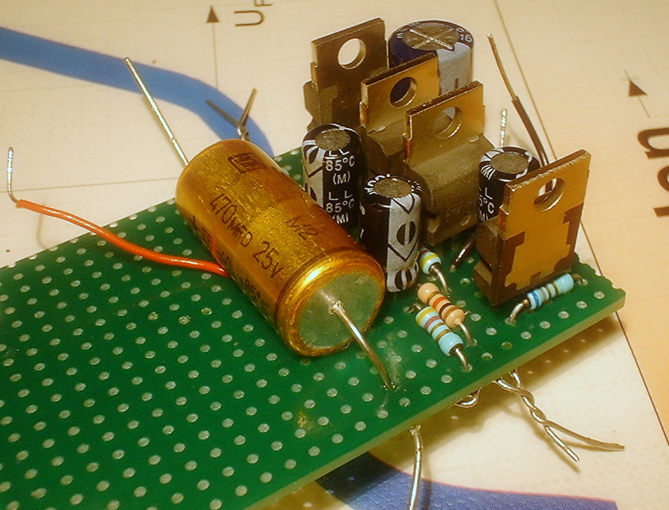

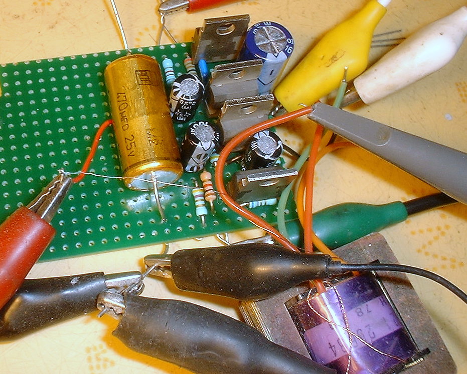

Here are the pictures of the prototype and the test set-up.

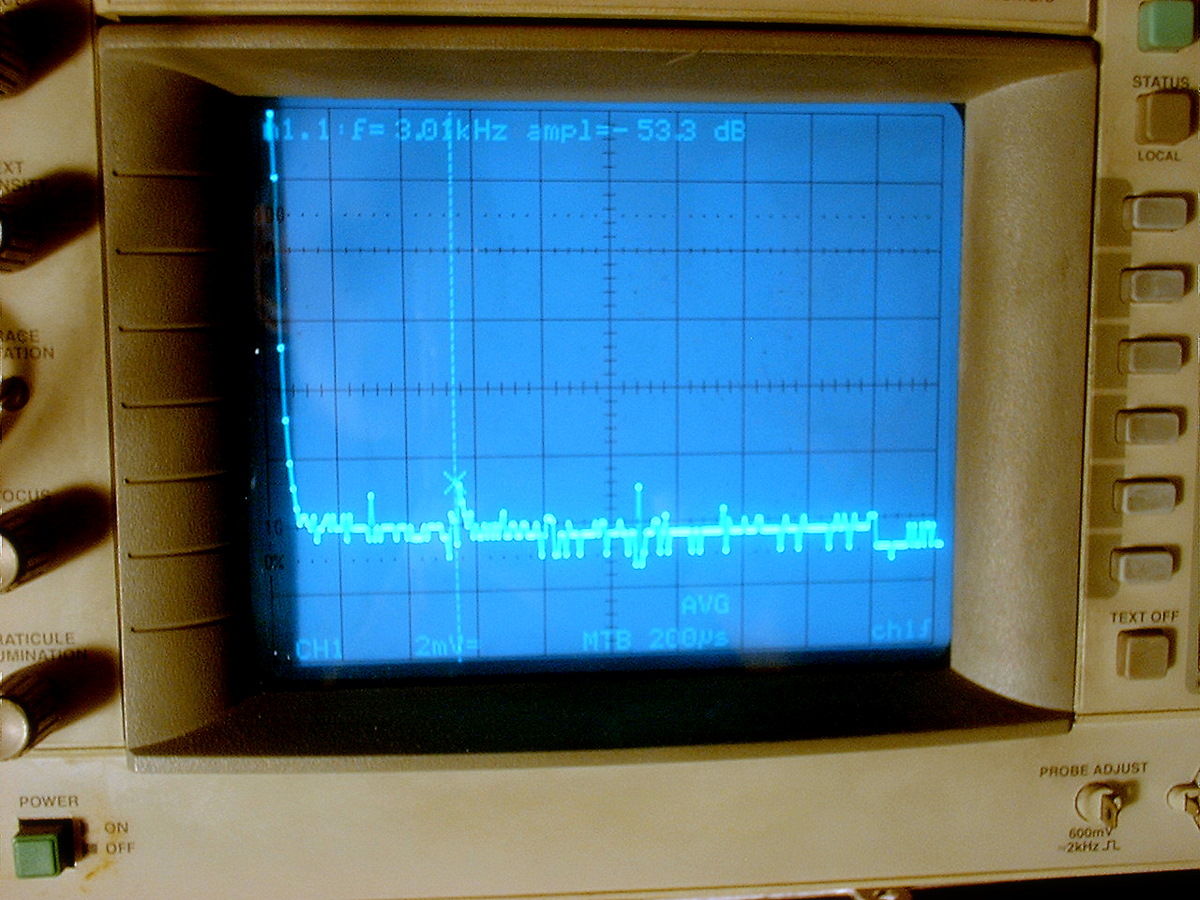

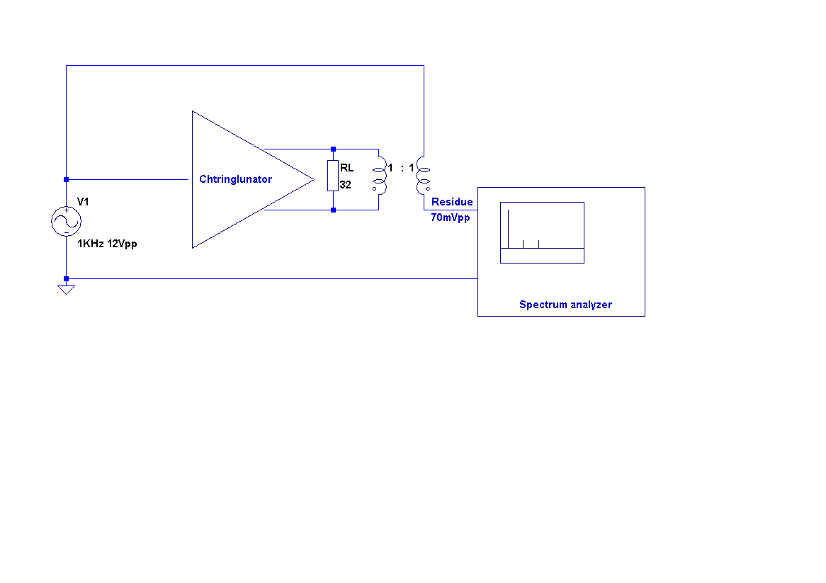

Measuring the THD proved quite challenging, not only because it is very low, and the circuit is a bit noisy, but also because the output is floating.
I had to use a 1:1 transformer, which served to subtract the output from the input.
With 12Vpp input, the residue caused by phase shifts, imperfections in the amplifier and transformer was 70mVpp. That's 44.5dB down.
The residue was measured on a spectrum analyzer (I didn't include a screenshot of the output waveform, it is just a boring sinewave).
The dominant harmonic is the third (cursor), at -53.3dB.
The global THD is about -51dB. Taking the subtractor into account, this put the actual THD at -95dB or 0.0018% (18ppm).

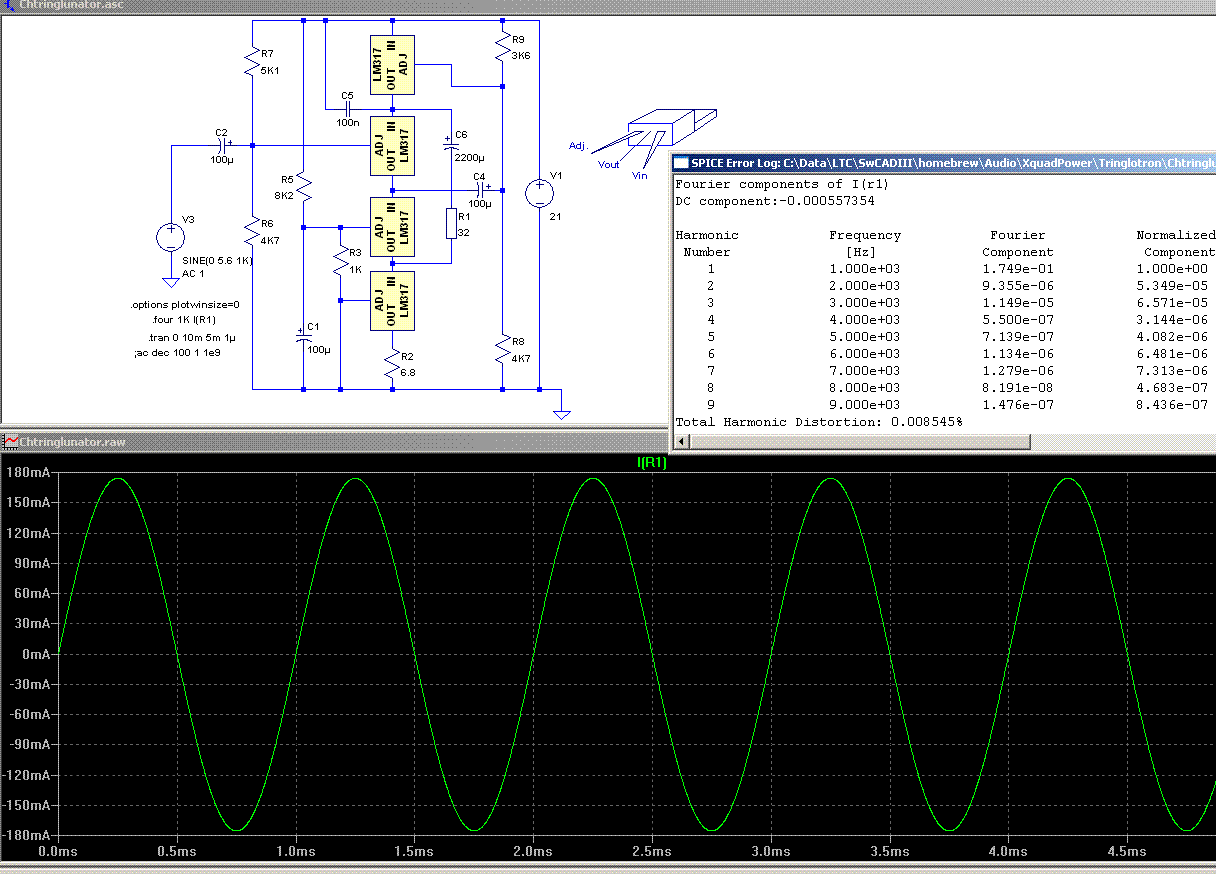

This is quite surprising, because the sim predicted a much higher figure of 0.0080%, and moreover, this figure also includes the distortion of the test transformer, which is subjected to the full amplitude of the signal.
This means the actual figure is even lower, particularly for the odd components.
The Tringlotron topology is basically asymmetric, and tends to produce more even harmonics.
The transformer is a very high quality one, salvaged from a professional Philips equipement, but it certainly contributes significantly to the THD figure.
The true distortion of the Chtringlunator is probably under 10ppm, and this is at the max power of 500mW.
At more reasonable levels, it is even lower.

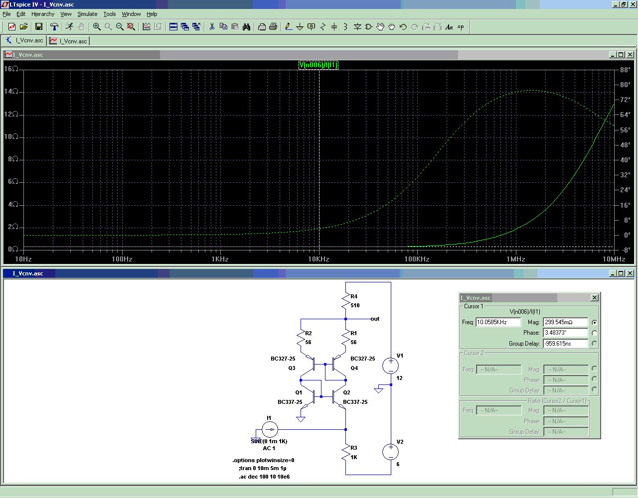

But the tringlotron principles can be applied to an I/V converter.
Here is an example: it is not very elaborate, and the performances are modest, but it shows the way.
With some minor modifications, the transistors could be replaced by voltage regulators.
