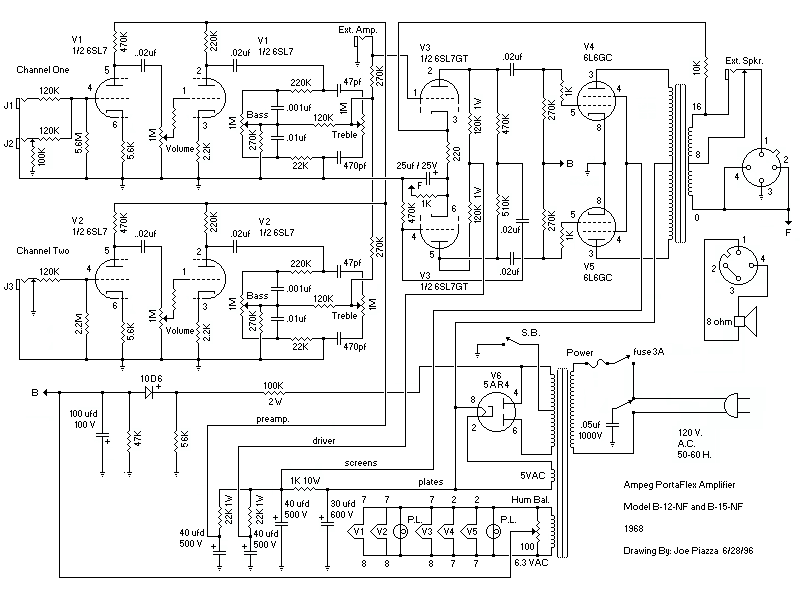

hello boyshere is my latest question...I finally decided to try the baxandall circuit for tone. some old ampeg portaflexes use an almost identical circuit with some different r/c values, but I dont know which to change...should I replace resistors 10 and 11, and caps 5,6,8,9? thanks
sorry guys, as I often tend to do I assume everyone knows what I am talking about so I dont explain myself enough. I intend to switch out the resistors and caps from my amp and put in the ones from the ampeg. I am converting my PA into a guitar amp, so the tone stack as is doesnt work, but I am not sure exactly how many of the resistors and caps to replace...will C5 and/or C10/R13 have to be replaced, or do they not have a bearing on the tone controls...thanks guys

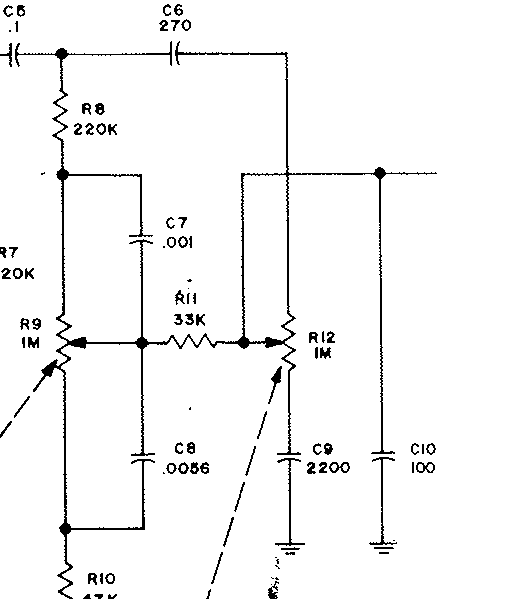

hello, after what seems like an eternity of trying to make this thing fit 800x600 pixels here it is. R10 is 47K to ground. I guess what I am asking in a nutshell is whether I need only replace the r/c values within the tone stack, or if I need to change more ie, ones leading to and/or from the tone stack. thanks agian guys
