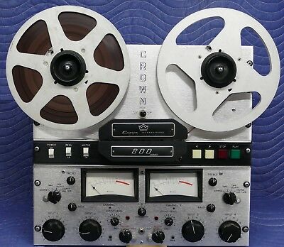

A pair of old Crown reel-to-reel machines.
One dates to 1959(tube model)
The other is a 1968 model.
Both have major issues, worn heads, bad motors, missing parts, etc.
Restoring these old buzzards would run more than $1000 each, and still result in sub-standard performance.
Not worth the trouble in my opinion, just metal for a shredder.

View attachment 1078650 View attachment 1078651
Offer them to people who need parts, anything is better then the shredder.
My neighbor brought them to me to inquire if they could be worth anything.
He sometimes brings me junk since he is not adept at choosing equipment.
Besides, he's already got a Technics RS-1500US and an Otari 5050 that I restored and overhauled for him a few years ago.

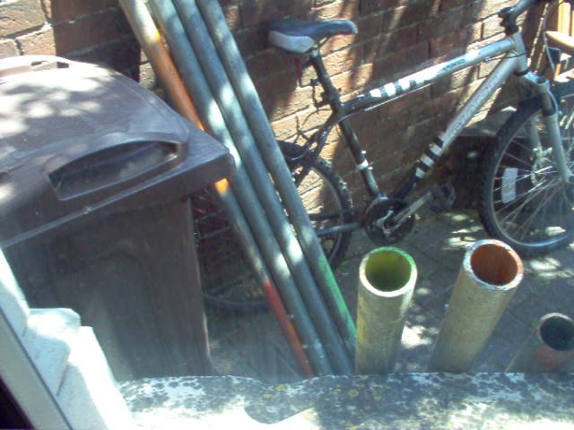

My good friend Lorna was yakking today that her bike, which has sat in her garden for a while, needed some work. Tyres were flat. :rolleyes:
I happen to have a bike pump, so offered to help. Alas, I had to change the rear inner tube as the work expanded with difficulty. This involved disconnecting the brakes and considerable oiling work on the rear chain and wheel nuts.
Anyway, I tested my work with a brief run down the street. All absolutely fine.
Off Lorna went. Only to return an hour later sadly pushing the bike. What had gone wrong? The back wheel had slipped sideways.
Courtesy says I can't mention to Lorna that the average UK bike is designed for a maximum of 18 stones or about 120 Kgs. The back wheel nuts had slipped.
Lorna is a hefty woman. Probably exceeds 18 stones. Maybe I should swap bikes with her. I possess a much stronger one myself! I am a mere 12 stone. And does anybody notice if you ride a girl's or men's bike these days?
