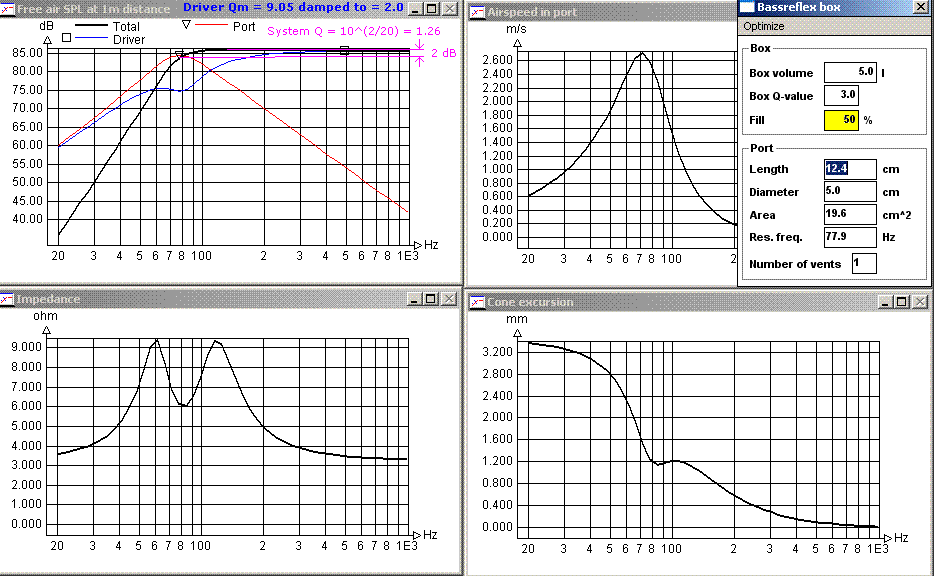

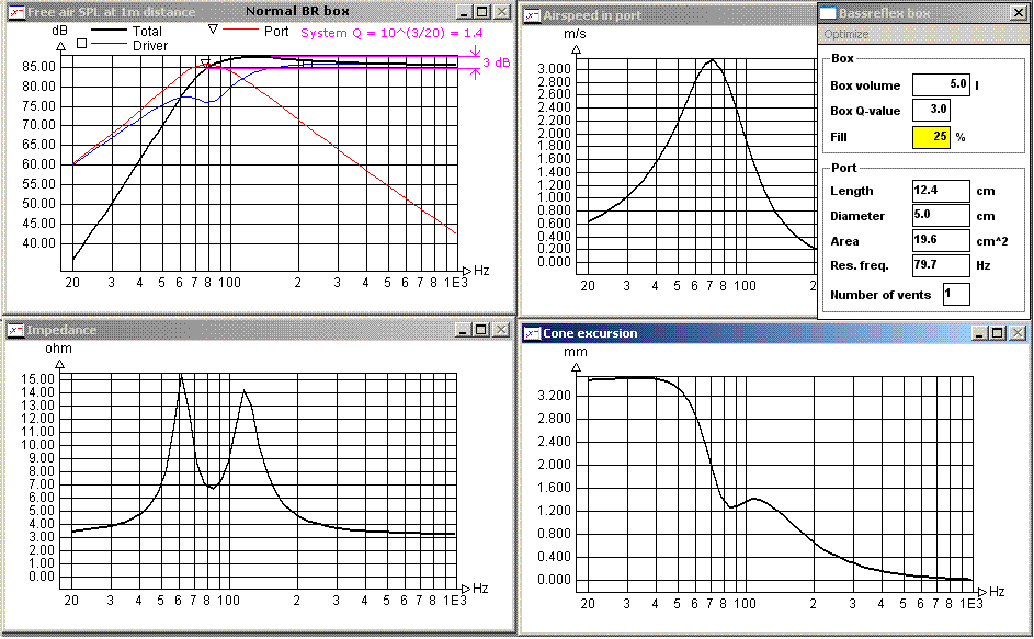

Hi sifis samos,
If you try using your proposed driver in a 5 L ported box (See picture 1(3)) you reach about 70 Hz f(-3dB) but the will be peaking with a system Q about 1.4. See picture 2(3).

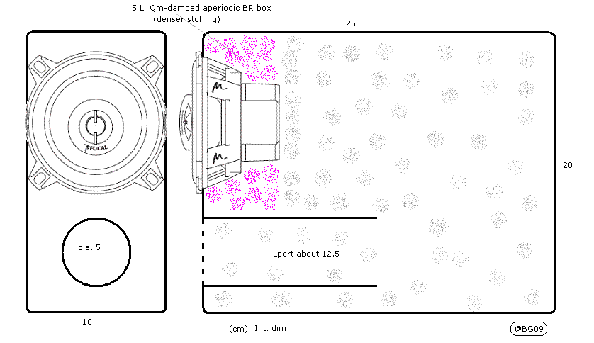

This Q value can be lowered down a bit by using the method of Qm damping (See picture 3(3), as the driver Qm can easily be pushed down from 9.05 to about 2 or even lower.
A Qm of 2 virtually results in a more suitable(usable) Qts value of 0.51 compared to the original Qts of 0.632.
The box system Q will then be lowered to about 1.26 (Qm=2) and the f-3dB point at about 75 Hz.
