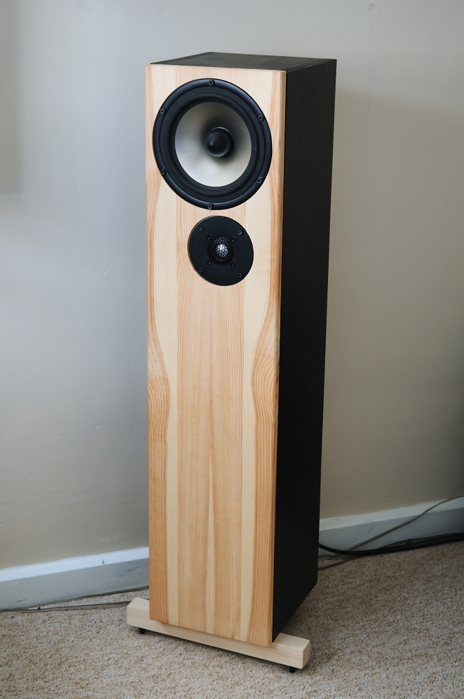

I'm currently using a SEAS L18 in a 24ltr ported enclosure. Bass is good down to 40hz though limited in 'impact'. I have a large sub so that isn't a problem.
It's impressed me so much I'm turning it into a three way with my favourite mid/treble combination of Morel EM1308 and SEAS 22TAF/G.
Here's the two way. The port is in the bottom of the cabinet. The speaker fits nicely into a small room.

That's really nice looking!
