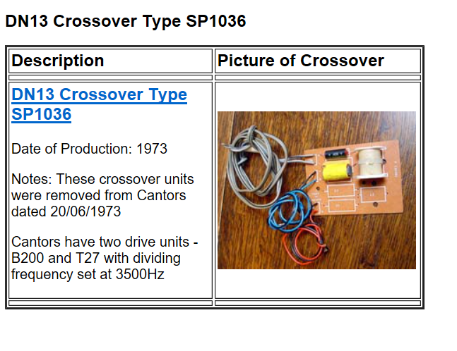

I have a pair of KEF Cantor speakers that I bought new in 1975. They sound OK but after 41 years they must be tired and probably not sounding as good as they used too. On the PCB there are 3 components: Large white cylinder with many windings around an iron core; another but smaller wrapped in yellow plastic tape, and a much smaller black cylinder with a wire from each end. This is stamped N.P. 93-7432. (I've Googled this with no results). I guess this is either a capacitor or resistor?
So, what exactly have I got here, and should I replace anything?

Anything like these:
KEF DN13 Crossover Type SP1036 hifiloudspeakers.info
If so then the black part is a cap, the yellow looks like an iron cored inductor and the white an airspaced inductor.
Edit... not sure on the white one. Has it an iron core ?

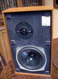

Bit of a classic, the old 9L KEF Cantor. Looks like a simple 2mH coil to the bass and 4uF/0.3mH tweeter filter. Or thereabouts. 😀
Anatomy of KEF Cantor
KEF got a lot of mileage out of the 8" B200 and 5" B110 bextrene bass/T27 mylar tweeter. Lots of variations. I think there were a couple of versions of the bass, designated by SP numbers.
Falcon Acoustics and Wilmslow Audio do a lot of reconstructions of the various old KEF filters. The 104ab was one. And they aren't expensive. Once you've identified the exact bass, there's nothing stopping you fitting some of the later, more sophisticated filters. 😎

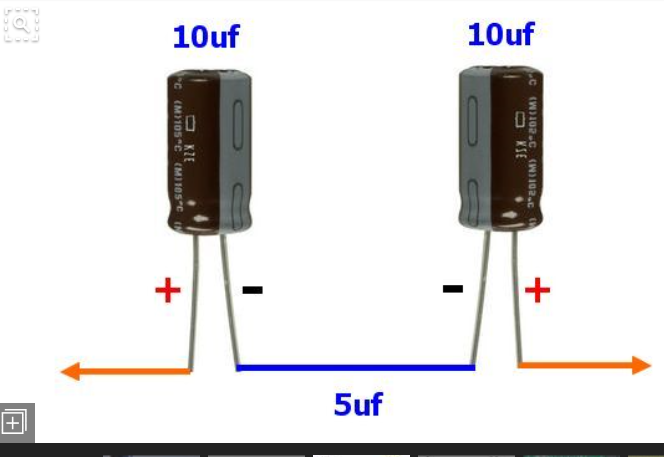

Electrolytics can be either polarised (the most common) or non polarised. You can also make a non polarised cap by connecting two normal polarised ones in series and back to back but the 'real deal' is better for a crossover cap.
