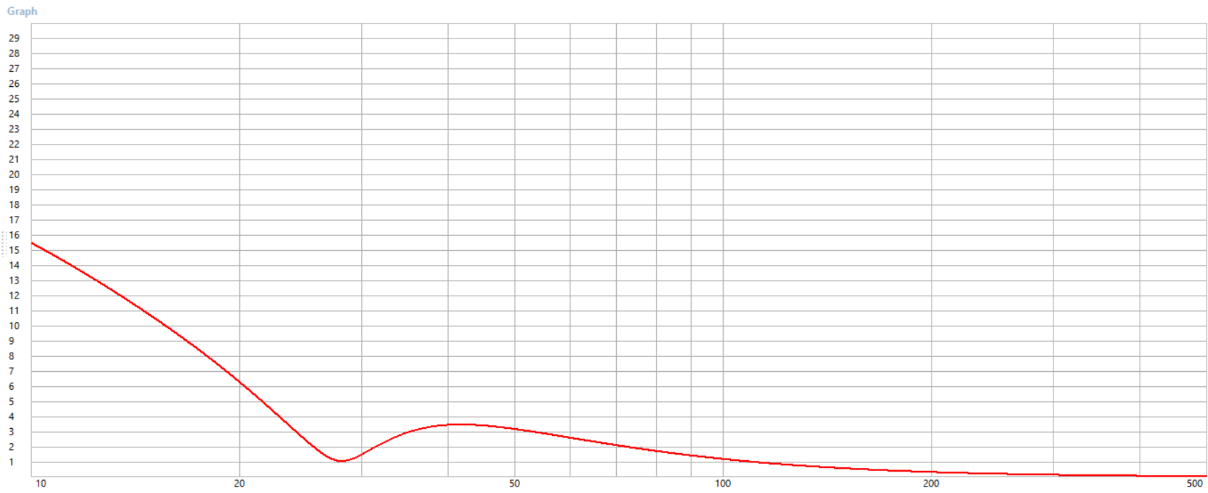

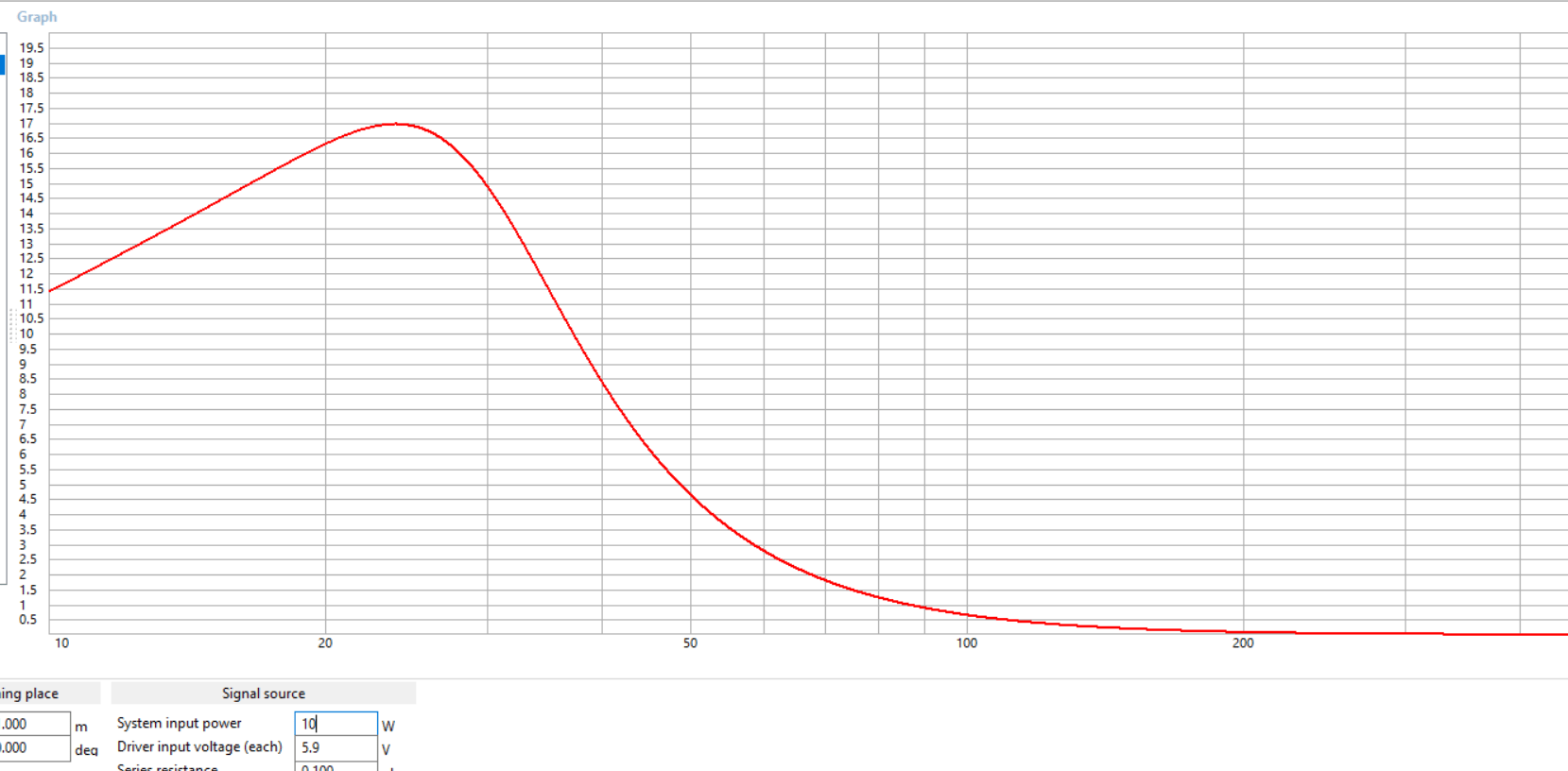

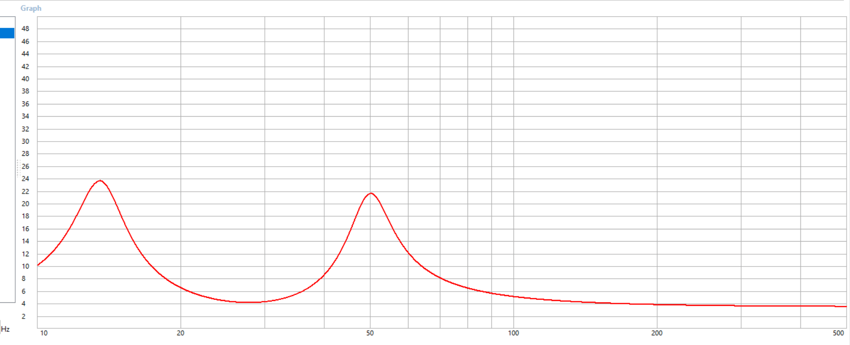

I modeled your driver and box in WinISD. The problem I see with a 5cm only diameter port is major port noise (probably fast turning into sealed box behaviour) with more than 10 watts input:
Impedance peaks should be symmetrical with a minima ~ 28Hz - minus box losses and without any damping nor EQ:
