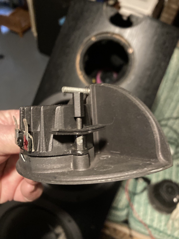

A pair of Wharfedale Opus 2-3s followed me home from the dump the other day. One works quite well and is at moments quite good sounding. The other side tweeter is dead or nearly so and there may be issues with the woofers (possibly muddy sounding). Not sure until I get more clear about the tweeter issue. I recently re-built a tweeter on another dump find (PSB Image 5T using this as guidance: https://wordpress.myon.no/misc/psb-image-tweeter-repair/) and it wasn't hard. I'm hopeful I can revive the tweeter on the Wharfedale but I can't figure out how to remove it. The tweeter is behind a plastic plate that has no screws. I've loosened the plastic bezel but can't figure out how to release it so I can get at the tweeter. I'll eventually remove the mid and top woofer if need be, but I'm wondering if anyone has any knowledge about how to remove these. Pic below is not mine, but it looks the same.

I assume it will be the same as similar looking warfdales I've worked on.
Remove the mid under the tweeter.
Put your hand in there and have a good feel around.
There will be a blob of black mastic.
This covers a nut and washer that thread onto a stud that is part of the tweeter trim.
The tweeter is screwed to the trim so the whole lot comes out as a single piece.
You have to remove the mastic with your fingers.
Have rags ready to wipe your fingers on.
Then remove the nut AND the washer.
Note that the top of the cabinet where the nut/washer is, is actually slotted.
So they will not come out unless you remove the washer.
The tweeter / plate assembly can then be wriggled out of the cabinet.
You most likely will also have to remove the sealing mastic around the wires from the inside of the cabinet as well.
The attached pics are of the last one I did.
They had obviously been attacked by someone previous to me.
So the finer details of yours might be a little different.

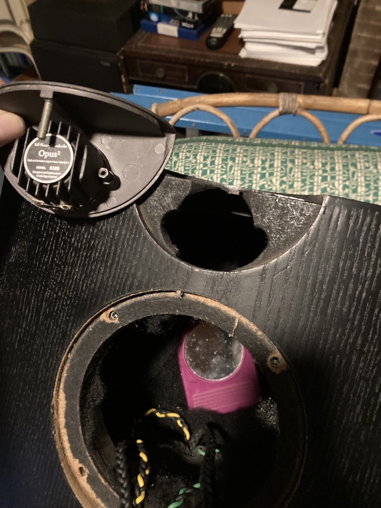

Progress! I was able to get the tweeter and trim piece off thanks to UserAbuser's help. It's a little different in that the bolts that hold down the tweeter also have some wings that hold it in place and tight against the baffle and I had to use a mirror (that pink thing) to figure it out and remove it. Now that it's out I was able to get a solid reading on the tweeter and it's reading 45k ohms on my multimeter. This obviously is an odd reading. I can't figure out why it isn't just reading open. I'll next try running a signal with a big cap to see if I get anything out of it. Ultimately if the coil is OK I'll probably try to rebuild the tweeter. I'll also look into possible replacements including originals if I can find any.

Drivers don't always fail open circuit.
High resistance (in a faulty unit) means its been over driven and the voice coil has started to burn.
That leads to a higher resistance of the voice coil.
It still means the tweeter is knackered though 🙂

I don't know for certain that the 0326H tweeter is a direct replacement parameter wise, but at the price it looks worth the try.
If there were to be a noticeable difference in response, it may be remedied by replacing both tweeters and/or an adjustment to the tweeter filter.

I signed up just to respond to this thread, since I just repaired an Opus tweeter last month.
I couldn't find the 0368 either, so went with an 0326, which are far more common, and used in many Wharfedale speakers of this era, including the Evo series.
Having also replace a tweeter in the Evo 2-40's, I knew what I was in for with the Opus - and it's exactly as shown and described above - yes, there are a little extra series of wings you need to remove (the small bolts do double duty holding the tweeter itself onto the aluminium mounting bracket). And yes, you do need a mirror, small light and some fiddling to get it done (along with a 6mm and 7mm wrenches / sockets).
To get the 0326 to fit, I had to dremel a small amount of material off the 0368's housing / heat disperser, since its wiring is a little different.
If anyone does find a source for the correct tweeters, it'd be great to learn where!

I can't tell an audible difference. The tweeters are rated very similarly in terms of specs.
