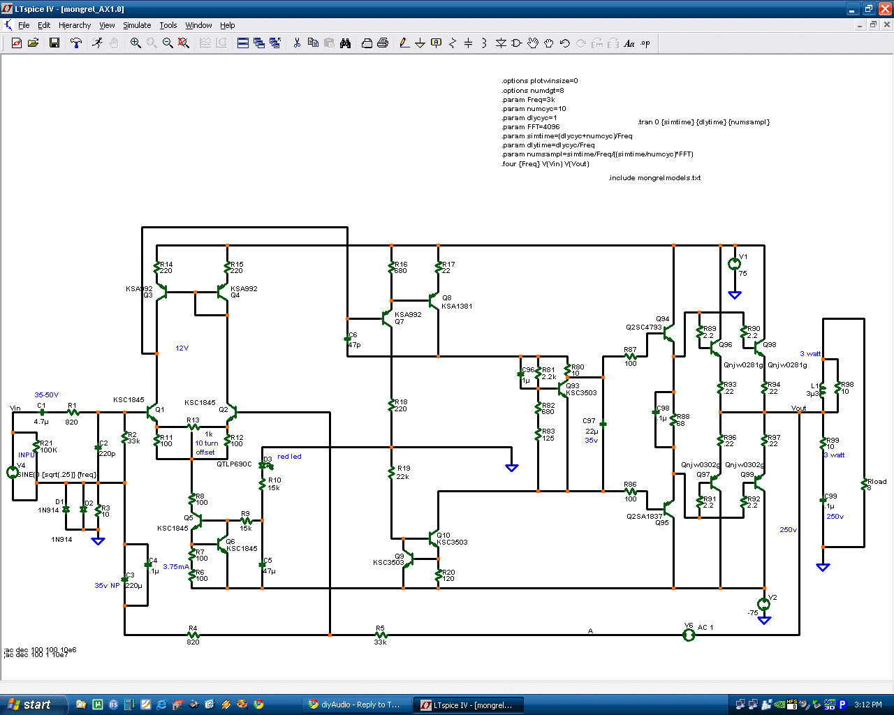

Just about all my amps have no thump or movement except my luxman clone. I traced this to the cascode capacitor. On powering down most will never exceed 20mV offset , this has to do with the LTP match mostly. I did build a current source free design once (like original DX amp) ... nice thump .
My blameless's (AX/BX) are so quick to start up you don't even know you turned them on .. not even a barely audible "tick" with your ear on the midrange .. much less any movement. The only way to see this millivolt turn-on is with a scope set to mV/div.
This is with these front ends hooked to a 200w - 8 output monster EF2.

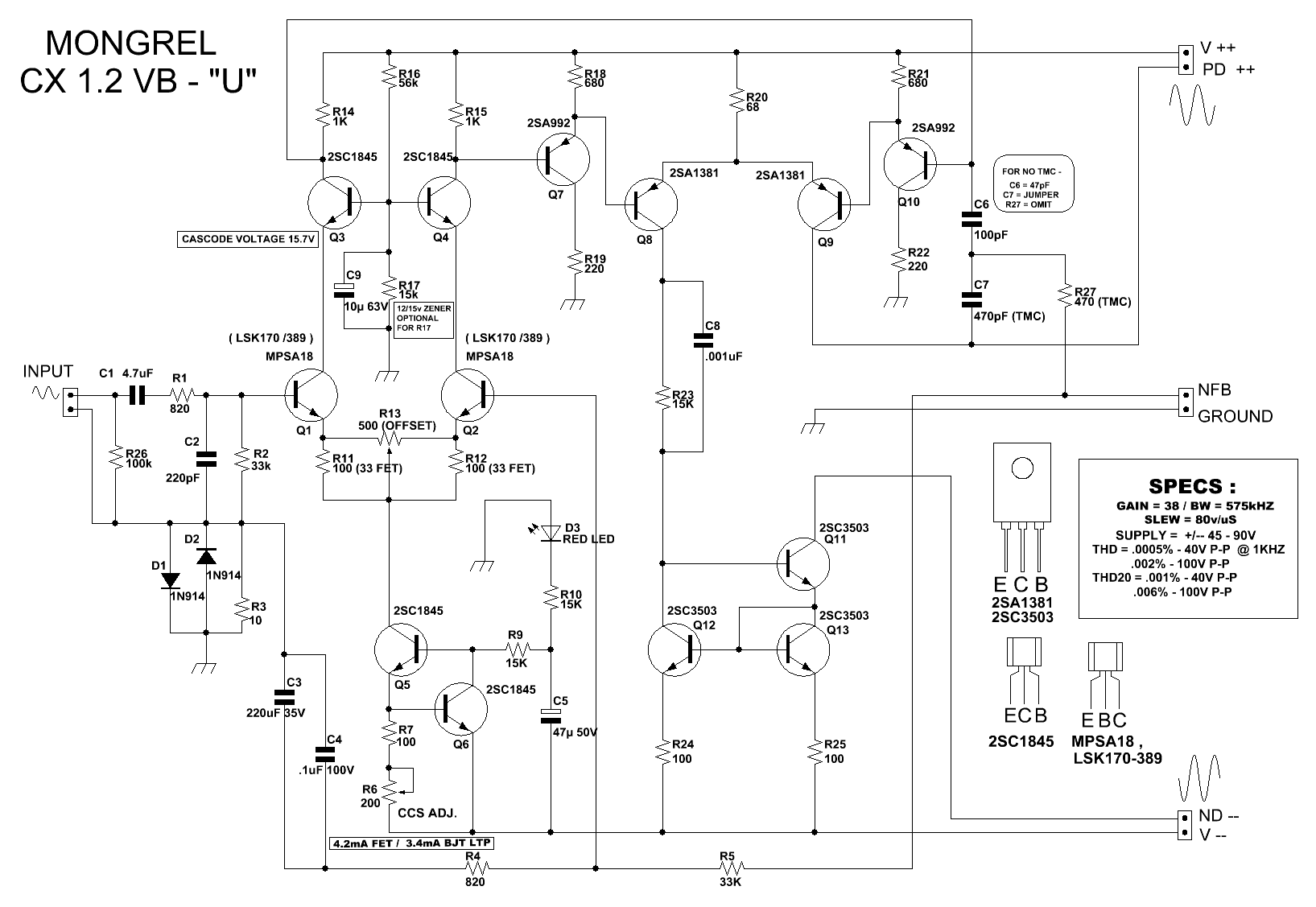

There is a mention in the Leach amplifier page about using resistors to supply the current for the ltp input stage (instead of a current source), which as far as i can tell, combine with caps on the zeners to slow the turn on of the input stage. I believe some other amplifiers use similar practices. YMMV.

I am revamping the PCB's and schematics now , so my AX , which I base all the others on , is temporarily gone (It is below). The AX (true blameless) , has NO thump or bass driver movement. I use the same NFB - DC referance ratio on all my amps (33k/820 w- 220uf NP cap). This gives me 38DB gain and no thump (except my luxman - I solved that.) Worst I have ever experienced is a small "tick" (sound) during turn on. Some don't even do that. A cheap sherwood discrete receiver is louder than my worst and it is OEM. The "tick" is 100mv max and lasts about 10uS on the scope.
On shutdown , no woofer movement either ... just a slight distortion as the rails collapse to around 8-0-8V.
The BX is just like the AX , but with a bootstrap on the voltage stage. Just a little louder click on startup (200mv/10uS) , still no woofer movement. My DC cap and bootstrap is this series by Nichicon .. (220u and 100u @50V)UVP1H221MHD Nichicon Aluminum Electrolytic Capacitors - Leaded
The topology I would want in a room full of nitroglycerin is the CX (below2) .. it has NO tick,click or anything. Must be the 5 device balanced VAS that does this.
