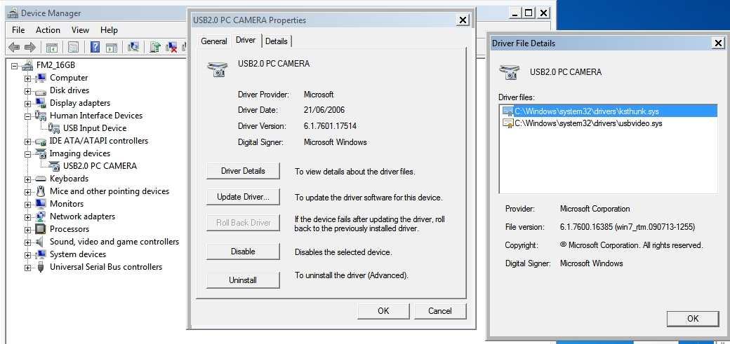

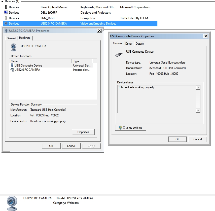

I am just starting out with astrophotography.
Webcam just arrived for the guidescope.
I connected via USB and it went searching for driver.
Now installed and it tells me it is working properly.
Here's the two screens confirming connection and operation.
How do I turn the webcam on?

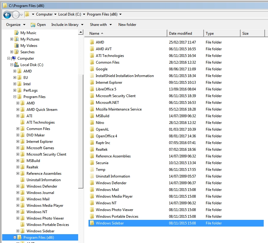

First try looking in
c:\Program Files and c:\Windows
See if you can see any folder that has the name of the camera or looks a likely suspect. If so then open the folder and see if there is a .exe file for the camera.

Andrew,
The dialogs you have shown only indicate that a camera is present and a suitable driver was installed to make it functional. That camera is now available to any software installed in your machine capable of using it.
