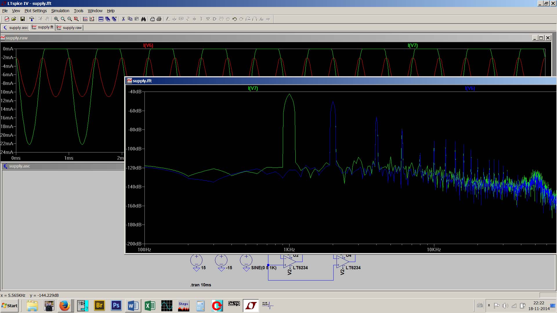

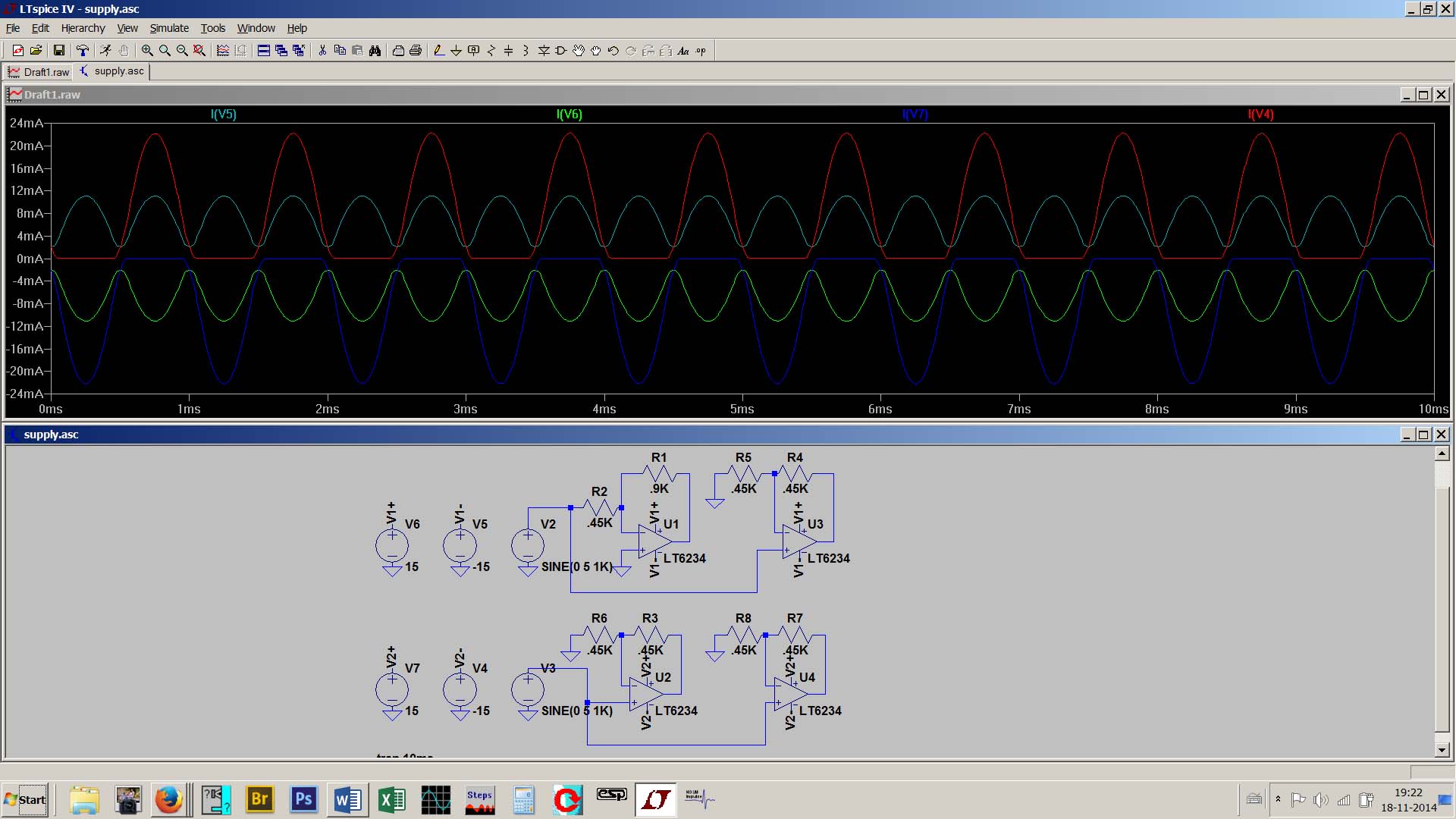

The reason is that in the lower frequencies, this draws current from the positive or the negative rail at the same time. Let me clarify this with a little sim I did. The load of the opamps consists of the feedback loop.
I took two simple opamp circuits connected to the same positive and negative rails. In the first option, U1 is connected inverted, and U3 non-inverted to the same rails. In the second option, U2 and U4 are both connected non-inverting to the same rails. The difference this makes in the current drawn from the rails is glaringly obvious. In the first option, current drawn from each rail is half of that in the second option, at double the frequency.
When looking at the FFT of these currents, it becomes clear that in the first option, the high peak at 1KHz you can see in the second option just isn't there. Furthermore, because the wave shape is much more gentle, the hash between the other peaks is lower too in the first option. Because they overlap it is difficult to see, but all the other peaks at higher frequencies are identical between the two options. But, as said before, the grass is a bit lower.
I think the implications are easy to understand. We should no longer build our power amps with both channels in the same phase; one should be reversed. Since speakers are a floating load, it is easy to accommodate this phase reversal by reversing the colours on one of the loudspeaker outputs. Plus, of course, we need an inverting stage preceding one of the channels.
Your reservoir caps will become four times more effective by doing so, just to mention one advantage (half the current is drawn at double the frequency). Also, maximum current drawn from each secondary is halved, potentially leading to less need for copper. Finally, the current drawn from the rails looks cleaner, which is no disadvantage either.

I think you are proposing to invert one channel of a stereo signal prior to entering a stereo amplifier, and then to modify the speaker for that channel so that the driver(s) has reversed polarity compared to the other channel's speaker driver(s). The benefit then being that if the stereo amplifier used a common power supply then the signal induced ripple voltage on the main supply capacitors would be a lower level for most common music material.
Yes Tim indeed, but it is even simpler. Just reverse the speaker output plugs for one channel on the amp. No modification of the speaker required.

Good to hear that it does indeed make a difference! And for such a simple thought, I was convinced about not being the first one to have it. But perhaps it is useful to bring it up again. I know for sure that the next amp I make will be connected in this way; will keep you posted.
