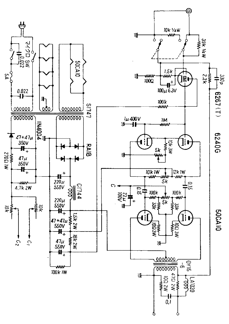

I advise you the luxman MQ68C in open loop. The Amp uses specially designed and manufactured for Luxman the 50C10 triode. This triode is derived from an old US one but purposely more nonlinear to provoke odd order harmonics of opposite phase.
It has a constant THD from 0.1W to 25W of 0.3% in open loop.
This tube is no more available, Luxman launched a similar amp using kt88 in triode PP mounted for 20W, I forgot the reference, it was in Stereophile magazine 3 or 4 years ago.

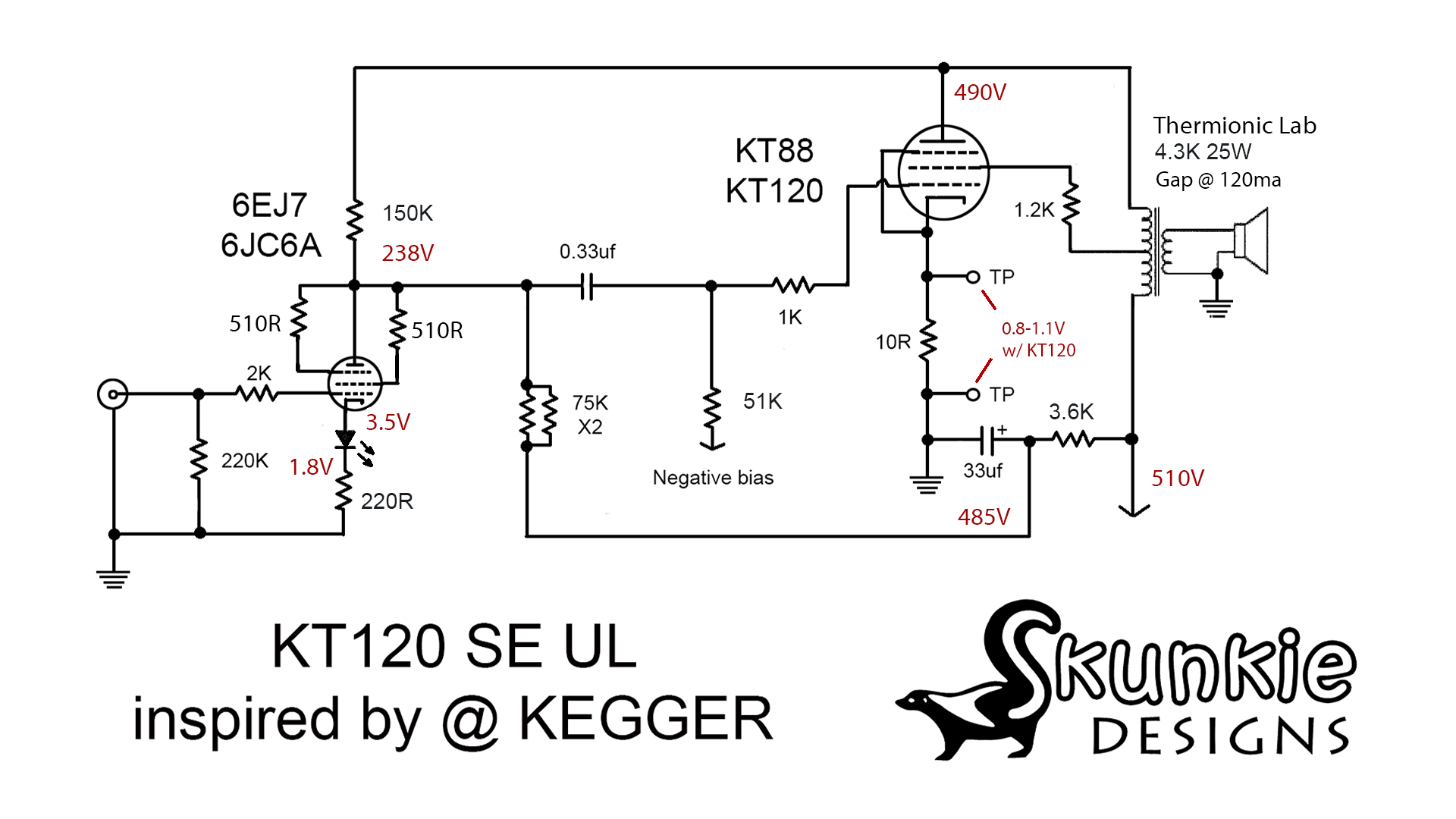

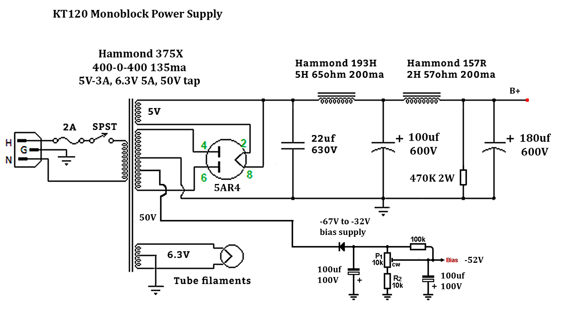

Here is my simple KT120 SEUL amp, which is a minor adaptation of a design Kegger published, and is a variant of that Blueglow/Kegger KT88 build. I built them as monoblocks with Themionic Labs OT and they sound amazing. I built them with fixed bias rather than cathode bias to allow them to be adjusted to use KT88 tubes as well.
I'm not sure how good it would sound as UL with no feedback, but I think if you triode strap the output tubes, you could eliminate it. Here are the schematics and I did a whole video series on building them. There is a video in series showing power vs THD testing, 18W at 2% and I believe around 10-12 at 1%. That was with the bias maxed out of what I would feel comfortable with.
One problem you may run into is finding a pair of KT120/KT150 tubes you can bias up to run single ended, higher than a KT88. Most of the newer samples don't like being biased hotter than about 80ma @ 500V without starting to red plate. Some don't even get that far. In my testing they need at least 80ma @ 500V % bias point to sound good. I found an earlier pair that are fine at up to 110ma, so they do exist. I believe it's due to the getter placement on some of them. Just be aware of that if you plan to run KT120/KT150 single ended. I cover that issue also at the end of the video series. Here is the playlist https://www.youtube.com/playlist?list=PLtEhh3UpOsiDh6orcLPoJjPWSy--6g675
