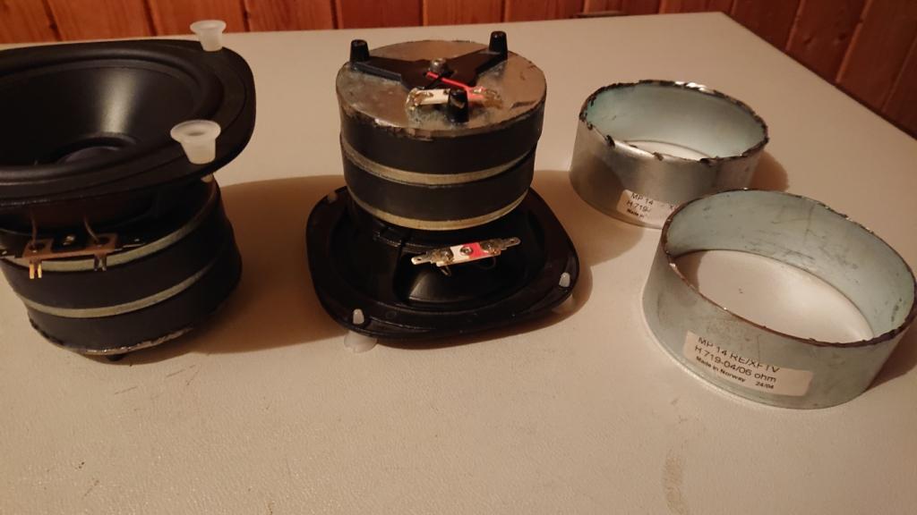

I got rid of my last CRT a decade ago, so the shielding cups no longer made any sense. My main reason for removing them, however, was that the outer part resonated like a bell. Also, the large (half a centimeter or so) gap between the cup and ferrite rings creates quite a resonant cavity, almost directly behind the cone. As a side benefit, the resulting smaller magnet profile should improve the termination of rearward radiation into the enclosure.
I kind of assumed that the shielding cups would be glued in place, so I never attempted to pry them loose. Instead, I took the quick-and-dirty route, and cut the outer part off with an angle grinder. I covered the chassis and soft parts carefully with a thick plastic bag, to keep metal debris out (and then spent an hour or three cleaning it off the magnet). The bucking magnets are still in place, as well as the remaining circular bottom part of the cups. Not the most esthetically pleasing job in the world, but it solved the problems.

Hi Geir,
The shielding cup removal sounds messy! Having done the cutting, does it seem that the cups / bucking magnets are actually glued to the pole piece?

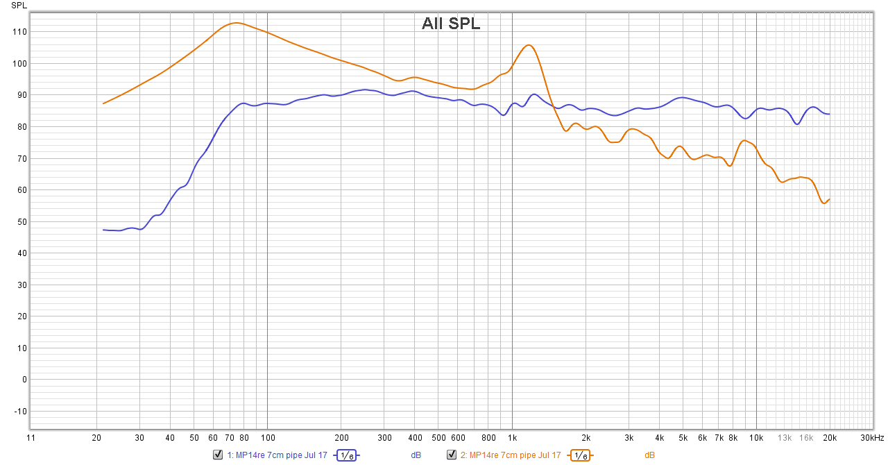

I have actually made a speaker using the H719 MP14, with an Al dome tweeter to replace the swapped out silk dome tweeter. It's a 4.5L ported box and measures quite well, although there seems to be some internal resonance at ~1.2kHz. I'm not sure whether this is pipe resonance or something else (shielding cup?). See the attached FR plots for the overall response and a measurement from inside the port. The FR bump at 1.2kHz still occurs when the port is completely blocked (stuffed).

Hi Daniel,
I think the cup must be glued to the bucking magnet, as it seems to require a lot of force just trying to get something sharp in between them (I've just managed to chip the bucking magnet, although I decided not to escalate the use of tools beyond a flathead screwdriver). The latter, I'm quite sure, is glued to the rear pole plate of the magnet system. If you want the cup and bucking magnet off, I really can't see a way to force them off, other than from the side (which means you'd have to cut the cup open first anyway). For that, you'd need a hammer and a chisel, alternatively a hammer and a knife blade you won't mind damaging. I suppose it's also possible to just break the bucking magnet into pieces, and take it all off in bits, although that would for sure be a heavy-handed and messy approach.
I doubt that the measured resonance is related to the shielding cup itself, although it should be quite easy to dampen that area, just to make sure: Stuff the gap between the cup and the magnets (both ferrites are 90 mm diameter) tightly with some damping material, and possibly put some bitumen padding on the outside of the cup, and it should take care of any potential issus.
Since you've already eliminated port modes, I think the resonance has to be caused by a strong standing wave related to the box dimensions. If the driver is in fact mounted on the symmetrical half-way point of a column, like you detailed in your PM, this is very likely the cause. Dampening out this resonance mode will probably require excessive stuffing, so if you can instead move the driver away from the middle of the column, that would the preferred way to go. The Golden Ratio can be a good starting point on where to place the driver: Make the column to one side of the driver ≈1.62 times the length of the other side, and the longitudinal mode should be significantly reduced, hopefully to a point where stuffing can take out of the remains.

Hi Geir,
Thanks again for the very helpful reply. The picture is informative...
I do note that some of the more recent shielded Seas drivers (e.g. H1333) do have open cell foam inside the shielding cup to provide some damping.
And, I agree with you about the standing wave diagnosis... I'll experiment with some variations on internal stuffing and brace / diffusion structures with the current cabinet before taking the big step of rebuilding with different enclosure dimensions or driver placement. As this is a centre speaker, I'm still hoping to be able to have a symmetrical appearance.
