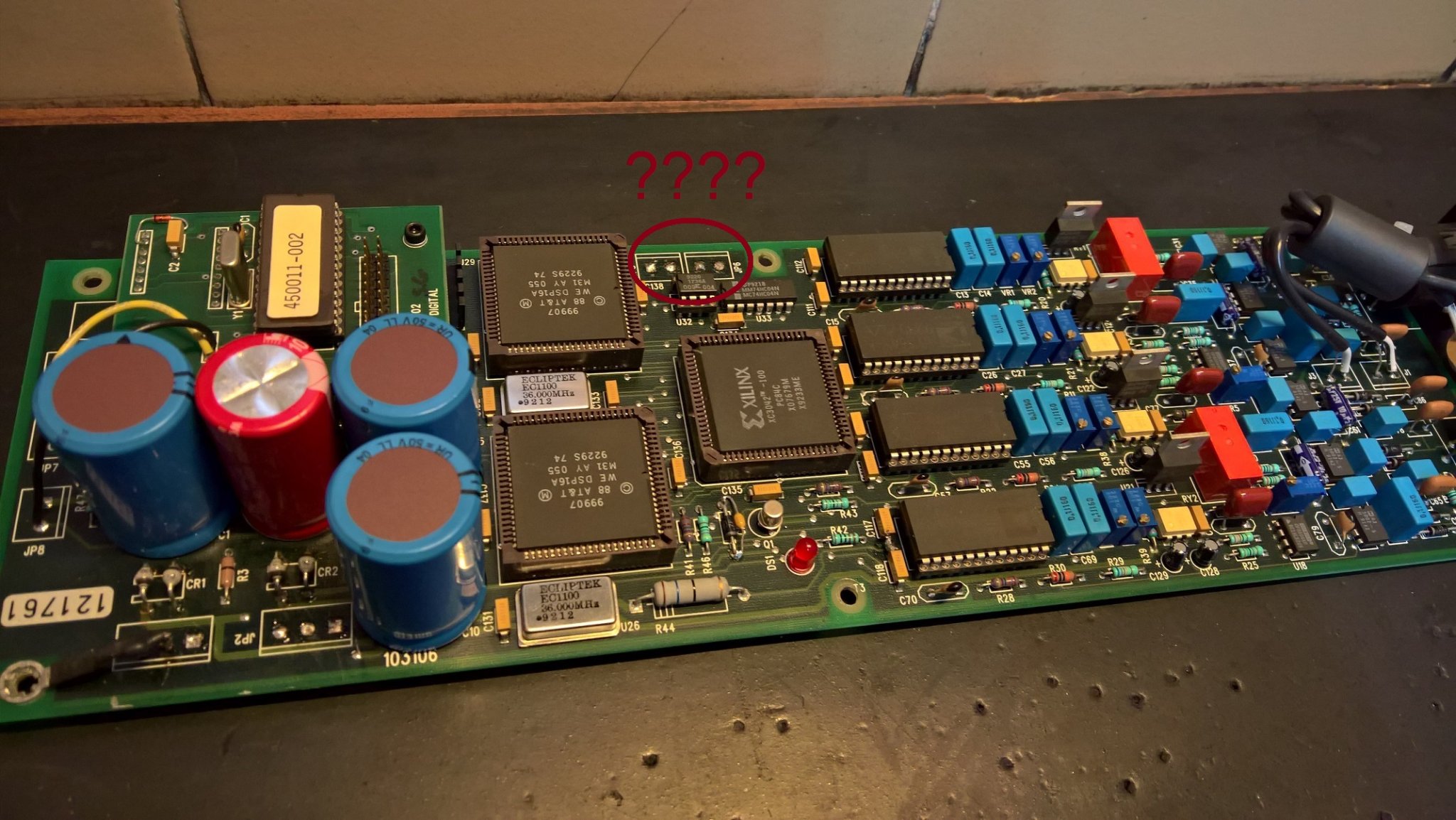

I have a wadia 6 without analog output. I check the DAC board and this happens!
I don't know why these cables are not connected (JP5 and JP6 connector). I need help to know where to connect them. Thank you!

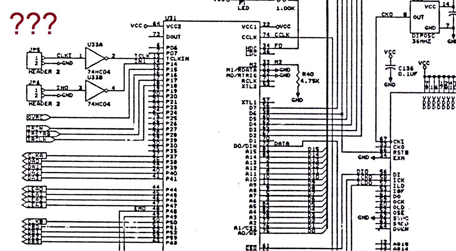

That's the dash input according to the manual, but it doesn't indicate which area of the P-500 transport they should connect to.

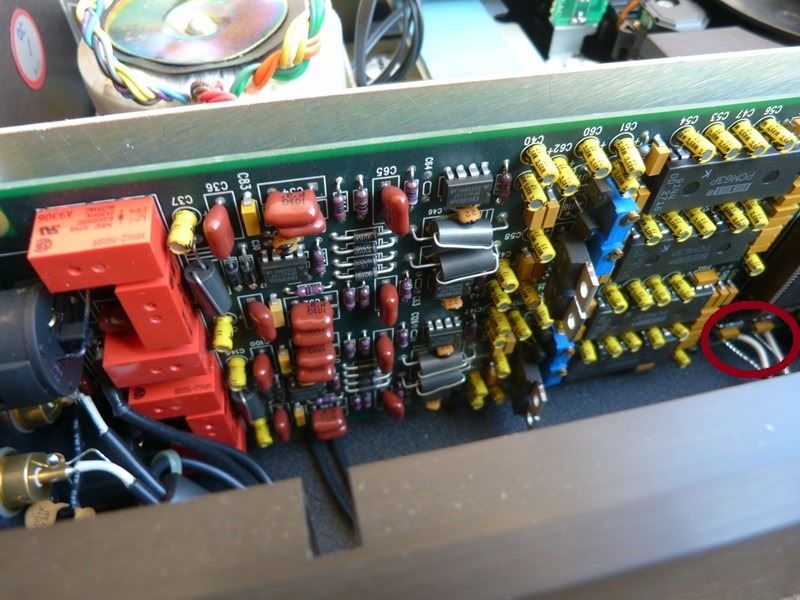

look for images on google and youtube videos of wadia 6 and get to see that they are connected, but do not see where.

This image is from Google

I imagined that at first, that clock signal is missing and the manual does not specify where it gets that clock signal from. unfortunately the version of the manual I got does not have a wiring diagram... :(
I am looking for someone from the community who has disassembled this machine and knows where these wires should be soldered...
I am sure that JP6 is the digital input that comes from the P-500 TEAC transport (it has spdif output via fiber optics)
