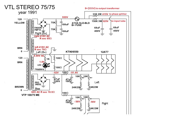

I'd like to recap an old VTL 75/75 amplifier and I'd like tho have some advice to choose the best value for many devices to use in the power supply (later, I'll ask for other issues).
As starting point I've drawn the schematics using the VTL 50/50's I've found on the web because it is very similar.
Though the VTL stereo 75/75 was a 75+75 watt amplifier it has only 90 uF (per each channel) to filter AC 😱... I'd like to increase this value to 340 uF (2x 400V-680 uF caps in series) as the "cousin" Manley Lab Stereo 75+75 watts shows 4 X 330 uF (series/parallel that is 330uF per channel) in its schematic and used the same power transformer (as far as reported in its original 1995 schematic as later it used a similar power transformer produced by another manufacturer).
I would not exceed 340 uF (per each channel) because I don't want to stress the power transformer too much with an excessive inrush current and because some people says that increasing to much the filter capacitance can negatively affect the sound.
Obviously I'd like to change the integrated bridge (with discrete diodes) even if the Manley Lab Stereo 75+75 watts schematic exactly reports the same Fagor bridge actually used in the VTL.

That is a 555V rail! The energy in 90uF charged to 555V is 13.86J. In a solid state amp with 40V rails (More than a 75W SS amp) u'd need 17330uF to get the same amount of energy.
So 90uF aint half bad. U have a hum problem with the amp as is?

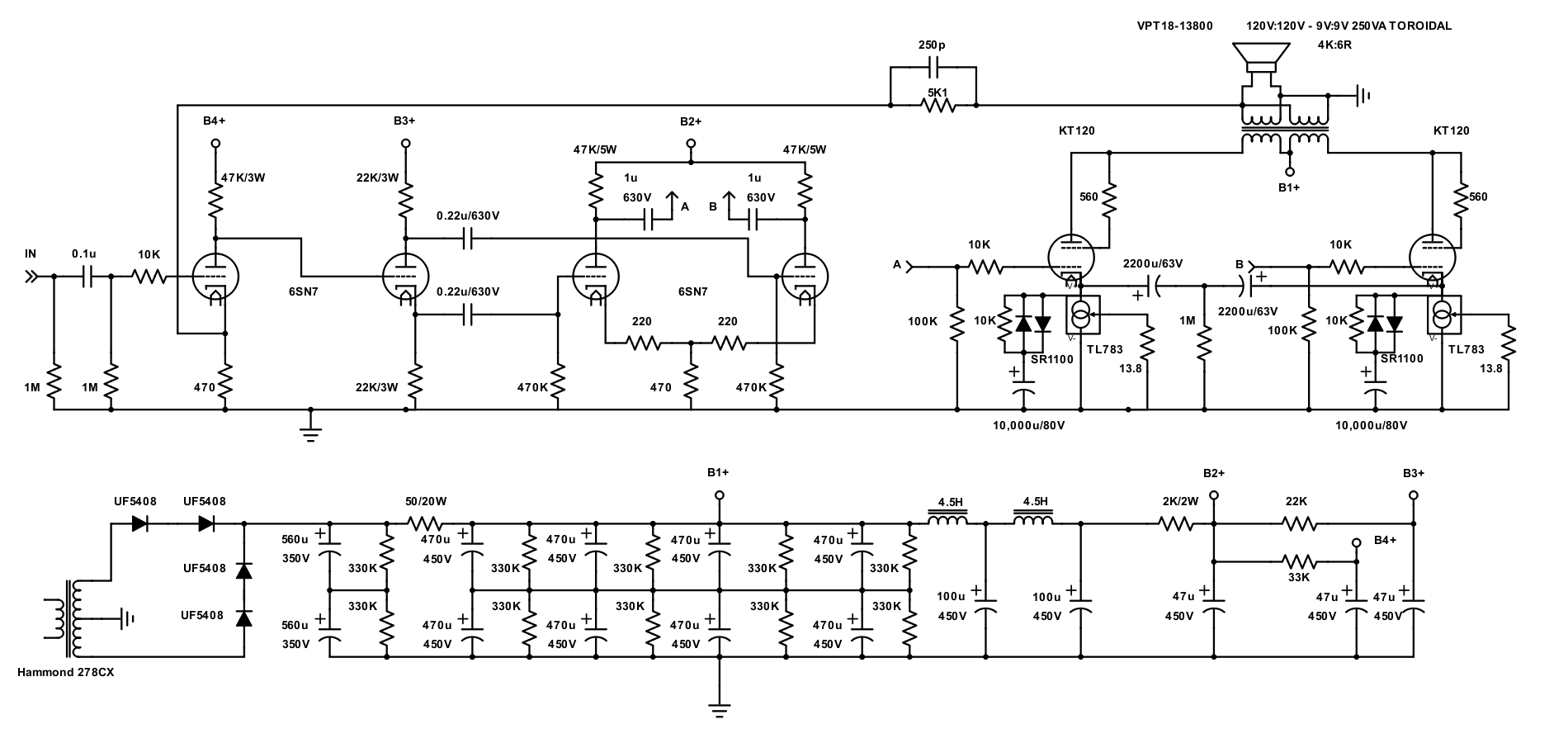

As far as diodes I find UF5408 to be more than good enough in my KT120 amp. I use them in series (for a bridge you'd need 8 diodes for 2kV PIV) It has 1200uf capacity at 540V (175J!) and these diodes handle the inrush perfectly.

I use them in series out of habit from when I used to use a large choke input. I found that sometimes when I turned off the amp the back EMF would blow the diode, so putting 2 in series increased the PIV to 2kV.
The first caps in the filter are NOS Nichicon, followed by Kemet PEH534, and the current of the B+ load is about 500ma. All of the caps after the chokes are Chinese but work perfectly fine. The stage after the phase splitter has 300R grid stoppers, but I forgot to put them on the schematic.
I will say my design is overkill, most people use a 1uF to 1ma ratio. In this case 470uF would work fine.

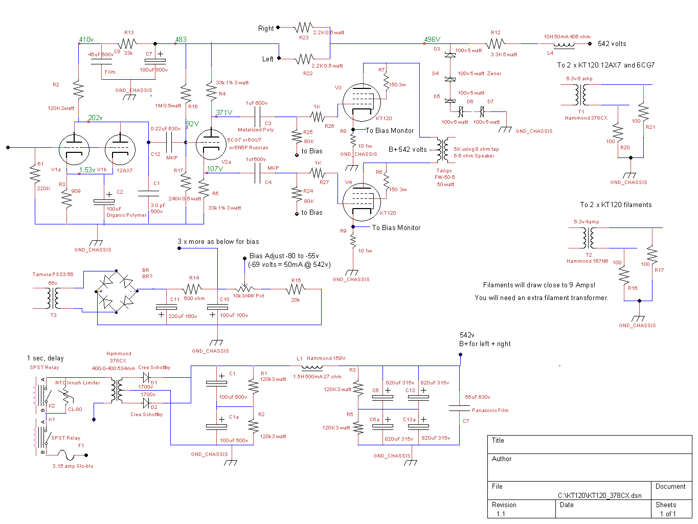

Here is my supply. I put in a big 55uF 630V film cap. Don't know if you can hear a difference. I can say that more uF's do improve the base for sure.
I bypass my NTC after 1 second which seems to work well. The Hammond 378CX is a big transformer ( 20 ohms in the whole secondary) and it starts fine with only a 3 amp fuse @ 120V primary.

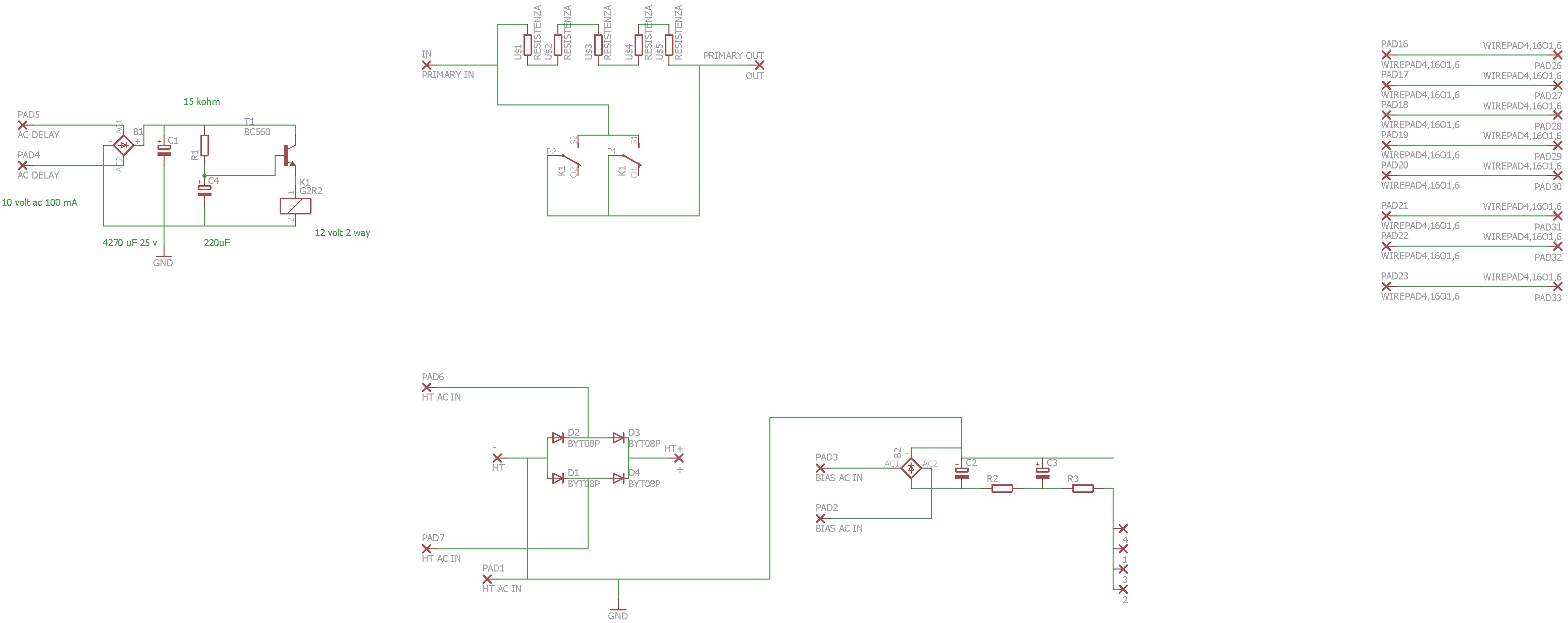

It's cheaper to just use one of these: NE555 DC 12V Delay Relay shield Timer Switch Adjustable Module 0 To 10 Second | eBay
