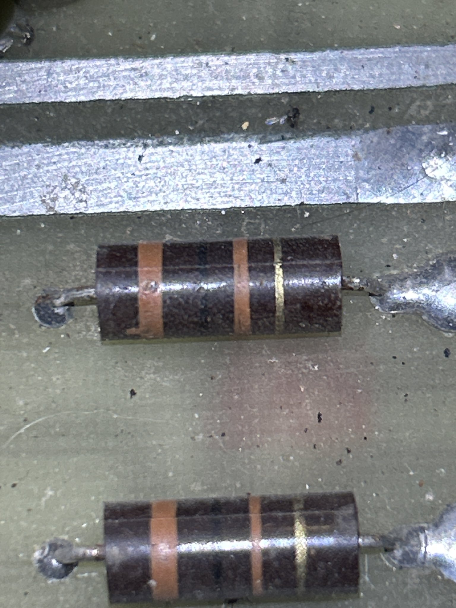

So I purchased a used Audio Research VT130 years ago. Now it blew a resistor , caused by a blown tube no doubt. What’s weird is the color code on the carbon resistors. These are 100 ohm resistors … why orange bands? Okay, I’m guessing because they can’t be brown since that is the color of the resistor? Does anyone know where I can get identical resistors for this amp?

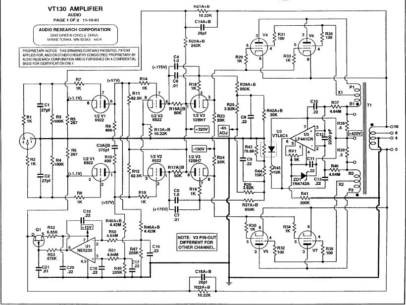

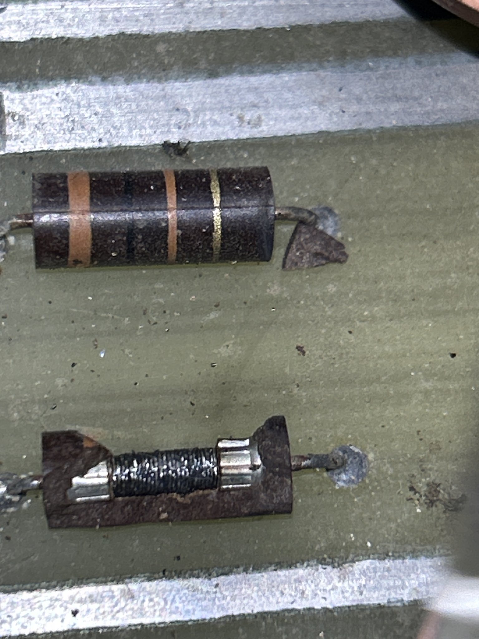

It appears R31 blew up.
Overheated resistors may change color. These high power tube amps with encased tubes really scare me and heat stress the components beyond my level of comfort. I second Chris that all these (g2?) resistors should be replaced. First things first, I would check if the caps are bad, if the drop across R38-9? is reasonable and then obviously replace all the bad parts. Old carbon comp resistors are know to STB every so often and for no particular reason. So tubes maybe ok.

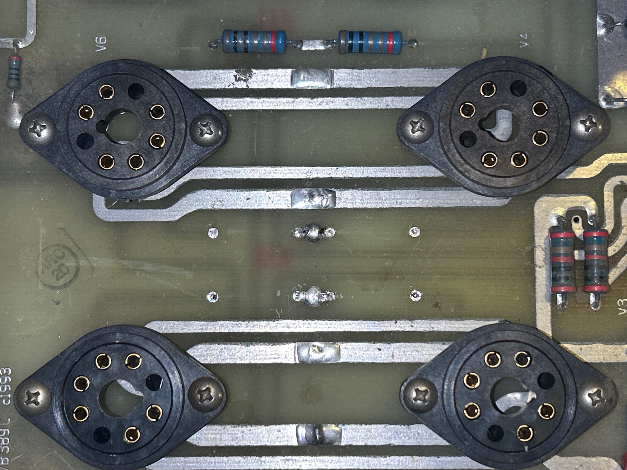

Looking at the poor general state of the solder joints, it seems to me the amp could use a little bit more in-depth refresh.

What wattage of resistors would you recommend? I suspect these are 1-2 Watts. I’ll look for a full schematic as well which should specify that.

During the years I also repaired a few of ARC tube amps for myself and friends, and the 100 ohm resistor are a common repair issue.
In later released amplifiers ARC have changed to 3W wirewound resistors, and when asking for replacements for the 2W carbon you have, they will send 3W wirewound resistors.
I think you safely can use a nice 3W wirewound resistor in this position without a sonic degradation.
Unfortunately I have to say that in my experience there is a faulty tube when this resistor blows.
Measure resistance between pins of all your output tubes.
Eventually you will find a short or unstable value that indicates which tube differs from the others.

What happens when a tetrode is operated with its screen grid floating?... Might I suggest that these all be replaced with very small versions of 100R in hopes that they'd fuse open sooner and possibly save the valves' screens?...
With G2 disconnected it cannot accelerate the beam, so as petertub says the valve becomes a (fairly poor quality) triode. But the valve is not damaged if the G2 stop is fused open quickly enough, so may live to fight again after the causal problem is fixed. Resistors are cheap, output valves are expensive, gotta fix it anyway, that's my line of thought.

So, I pulled the resistors on one channel.
ordering this non-inductive wire wound resistor:
https://www.digikey.com/en/products/detail/ohmite/WND100FET/3114550
and this Vishay-Dale:
https://www.digikey.com/en/products/detail/vishay-dale/RS02B100R0FE70/1166406
I'm just going to go ahead and order both of these ... any votes on which to use? Never used Ohmite before, seems like a good choice as it is a non-inductive winding. Any complaints with Ohmite, reliability or such? I saw no inductive spec on the Vishay but it is likely fine too. thoughts?
