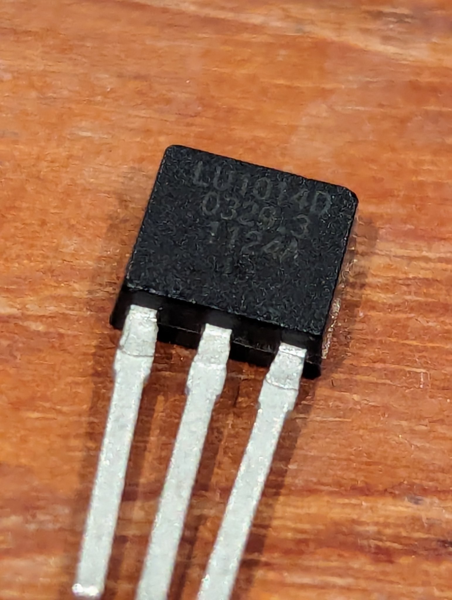

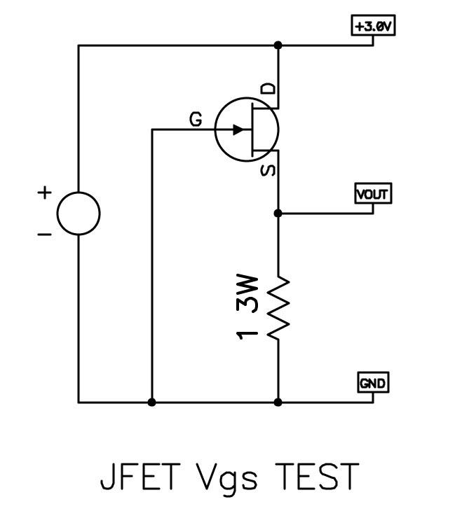

My (cheap) transistor tester says: N-JFET, I=2.1mA, Vgs=1.4V, which seems very high considering the distribution Nelson posted in the thread here (highest value being 1.15V in his sample).
When I measure using the schematic on the same thread, I initially measure only 0.75V (increasing as the temp on the Jfet rises) which seems very low.

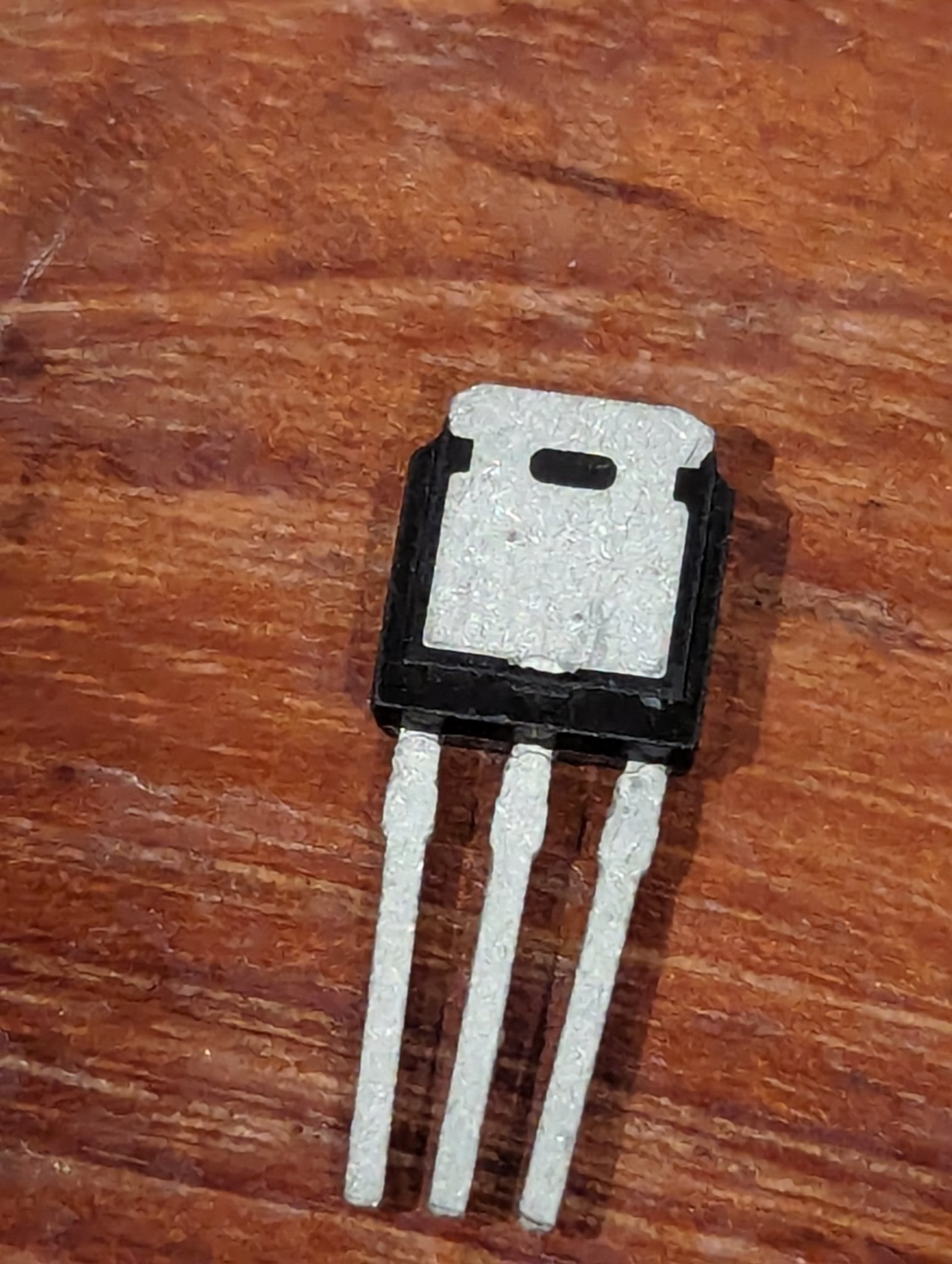

Below pictures of my (fake?) LU1014D
BTW: Even without the LU1014D I cannot get anywhere near 9V on the gate, try for yourself at https://www.circuitlab.com/circuit/w78qexd53wvq/test-2/

if you test properly your JFets and it shows that you don't have proper part, you can't expect to make functional amp with non- functional parts
ask around or look directly in Swap Meet, those are not so scarce
when you get genuine parts, go further with your build
If you get 2.4V at 1.2 ohm resistor to ground, then you have 2.4/1.2 = 2 amps through the resistor and also the JFET. It seems like the JFET is shorted or fully turned on.
Did you check voltage at the JFET gate? Just to cover all possibilities, measure Vgs.
I'm away for a few days, but I have a few spare curve traced LD1014Ds and I can send you two when I get back.
Gate voltage is 0V, so Vgs is 2.4V.
A shorted Jfet could indeed be the cause! That would explain the (almost) exact same voltage on drain and source AND the fact that the mosfet is conducting.
