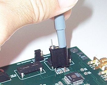

Thanks for the help. If it is the leads, how do I get rid of the pickup. I have tried ferrites on these and inductors on the output of the opamp without success. Needless I have re-routed cable runs etc. This will be the first time I have come across the problem on any CD or SACD player. The spikes appear whether the top is on or off with no change in level. As I said, thid unit has more inductors and bypassess than I have come across normally.
Like this: (see pic)
I use this special ground lead attachment for high bandwidth work. And the probe is a special 5k ohm 1.5GHz design. I also have a 500 ohm 3.5GHz probe that works even better on low impedance (e.g. power supply rails) signals. Photo shows a clock & data recovery circuit running at 2.5Gbps with 100ps risetimes, and a Tek P6057 (rare) probe.
What you really need is a very expensive and professional differential probe.
Or try this: remove the probe "hat" and ground lead, use a piece of 22AWG bus wire (or maybe even solder) and wrap it around the grounding ring near the tip pf the probe. Leave one end hanging out near the probe tip. Now you have the tip and ground a few millimeters apart. The ground lead is as ashort as you can make it. This will help greatly in reducing the pickup from the probe.
If you have switchable probes, change to the "1x" setting. You have to get the impedance down.
Another approach is to make your own probe out of 50 ohm coax. This is a bit more involved and requires a 50 ohm termination on your scope's input. Email me if you want details.
