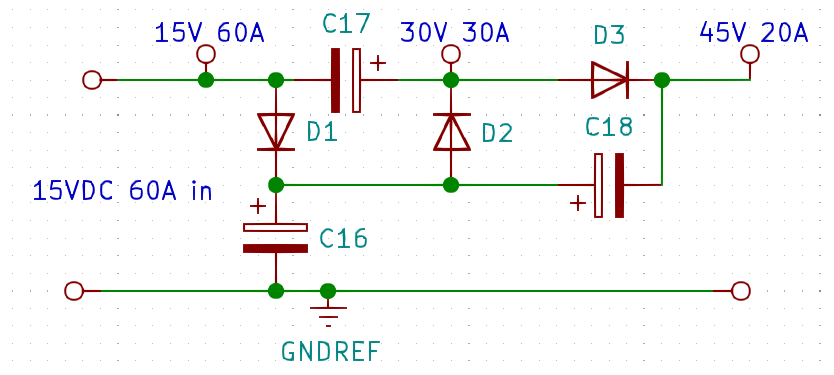

I think I have copied the simplest voltage multiplier correctly but as you can see it is a fairly high amperage. Not sure what SMD components to choose or if it is even the best circuit?
I would like to minimize the Voltage loss as much as possible, first to avoid heat but also to get as near to 45VDC as possible, loss in Ampere do not matter.

The input listed is DC 15V, and will not work. Do you mean AC 15 Vrms?

Unless I am having a senior moment, that won't work. VOltage doublers don't work on DC. If you apply +15v to that, it will flow directly through D1, D2, and D3, and on to your output. You will thus get +15v less three diode drops, approximately one volt each.
Current is not pushed into things, things draw current from the source. SO if you had a 15v input capable of 60A, the output could draw as much current as possible until it burnt out a diode.

If you are restricted to a DC source, you will need a switching DC-DC converter.

I have a 0-15VDC 60A but need the possibility to get from 0-45VDC

It is possible only with dc/dc converter (boost type).Thanks! No I try to convert DC to 1x/2x/3x DC 🙂
If you have 15 V AC, and want to make powerful multiplyer - for such large enough currents you will need such a big capasitors (tenth or hundreds of millifarads), that it may be cheaper to use rectifier and dc-dc instead.

There is no way to multiply a DC voltage.
No I think I have learned that... thanks to you all!🙂You mean like a capacitor-diode voltage multiplier running from AC?
Am I right in that you can only multiply DC by chopping it up or convert it to AC?
Yes, thought that was very clear... (Although this is electronically, you can connect two DC motor-generators together).
