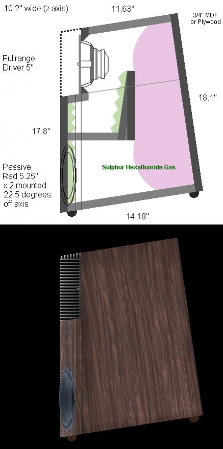

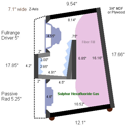

This is a hybrid design I created with small (desktop) size in mind. Its a partially stuffed folded pipe with driver 1/3rd from tapered end. I added a passive radiator in place of a vent to hold in the sulphur hexafluoride gas. Sound in this gas is slowed down to 44% of its speed in normal air. It is 6 times denser than air.
Fountek FR135EX 5" Full Range
https://www.madisound.com/store/product_info.php?cPath=45_241_307&products_id=8817
Peerless 5.25" Mini Passive Radiator
https://www.madisound.com/store/product_info.php?products_id=1748
Now to build and test.

In that case, wouldn't it be better to have more than one of these passive radiators, or maybe even go to an 8" one?
Shouldn't be much leakage with the interior coated and sealing putty under the driver rims.
More concerned with the internal volume, but a pair of side radiators would be interesting.
When Dayton-Wright did this the gas was in a plastic bag.
dave
Hi, I'd walk before you can run and take on board very dubious claims, rgds, sreten.
