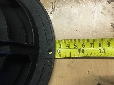

Additionally, there's currently a pair of Vifa M22WR-07 on eBay UK. ( they might the worth "shot-in-the-dark" gamble )
I have no idea how the "-07" model is different from the "-09" model .
It seems to be the same diameter.
