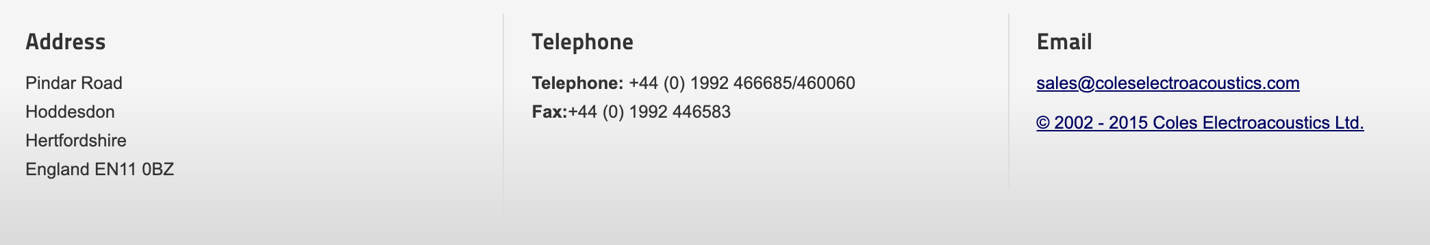

I can't locate any 16Ω diaphragms but in another thread here someone suggested contacting Coles Electroacoustics. Worth a phone call at least.
I actually did that, but they did not have any such parts any more.
They once had their own replacement for the HF1300 called "3000", but this is no longer produced. I bought the super tweeters 4001K from them, though.
