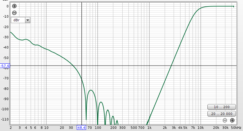

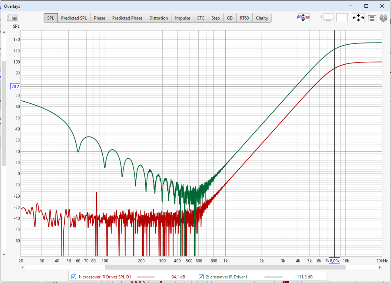

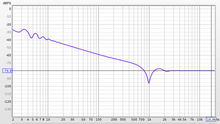

I have designed a digital crossover and exported the impulse response. When looking at the hipass filter frequency response with REW it appears that the low frequency attenuation is quite poor, REW shows a positive slope. At 2Hz attenuation is only 20 to 30dB and continue to rise I guess up to 0dB at 0Hz.
Here is a plot of a simple LR36 at 8KHz:
I should have missed something but can't figure out what...

Only from result is nearly impossible to find out what you had missed, describe your filter/impulse creation process with more details.
Is the measurements in post #1 form the real world? Does your physical equipment really support 64k taps?
When number of taps is not enough, the filter don't looks as anticipated. This can be seen in the program rePhase where when one generates a filter and the taps are not enough, the final curve don't match the specified one.
But this is somewhat of a long shot, so...

not a real measurement, the wav file impulse response is imported in REW. I tried using less taps, it's the same. Yes the convolver support 64k taps.
This is is a real measurement in the digital domain of my crossover high channel:

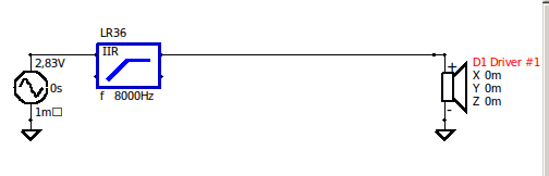

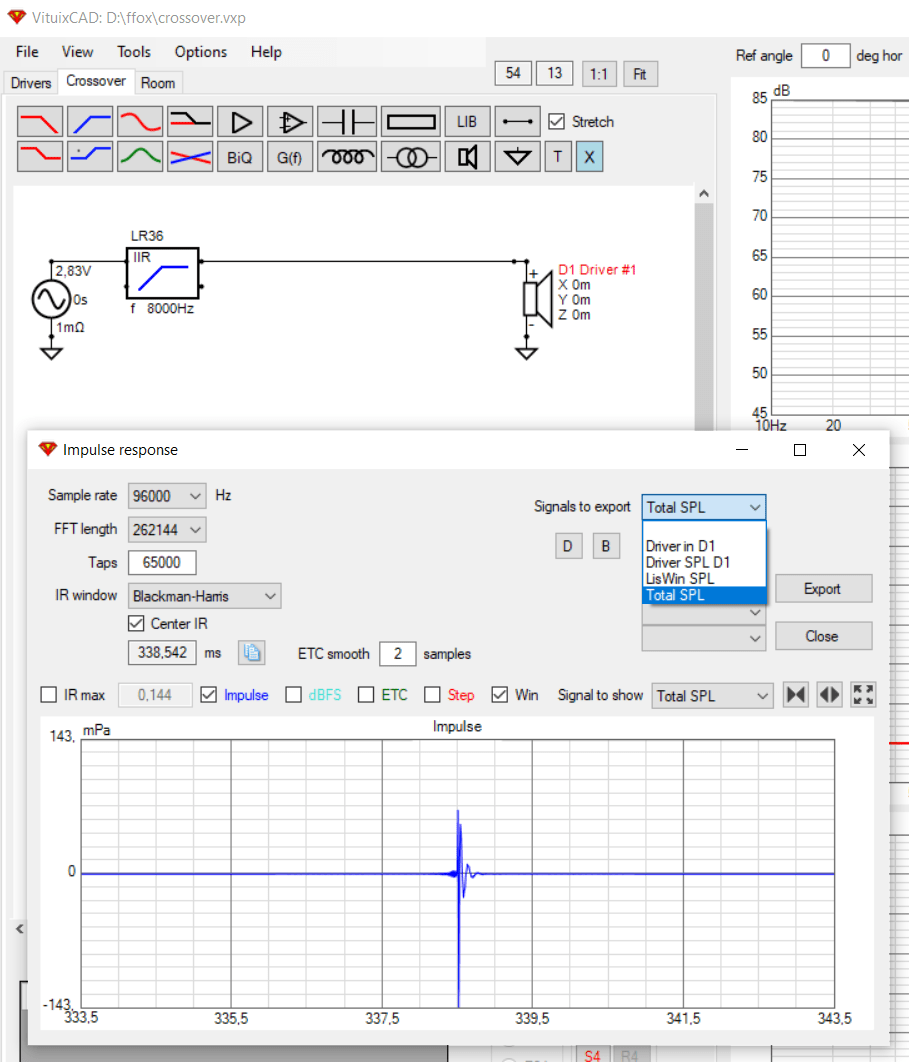

Hi, haven't used VCad for a while...so I'm guessing here....filter is very simple :

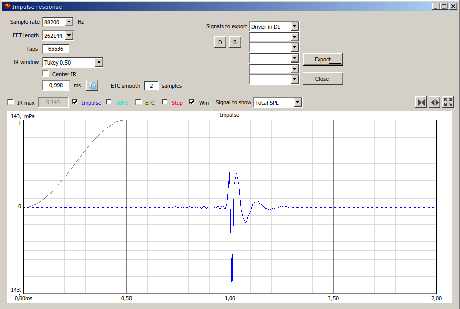

Impulses is created from the menu View - Impulse response :
Vituixcad file is attached, just remove the added .txt extension.

Check the "Center IR" box.
That will produce a linear phase FIR file, which I'm assuming is what you want anyway.
Because otherwise, why not just use IIR to begin with...
Of course, FIR can be used for IIR replication, and quite successfully by moving impulse towards start.
But I've found if impulse is immediately close to start, results can sometimes go unexpectedly wonky.
Hi, same 8KHz filter "Center IR" box checked :

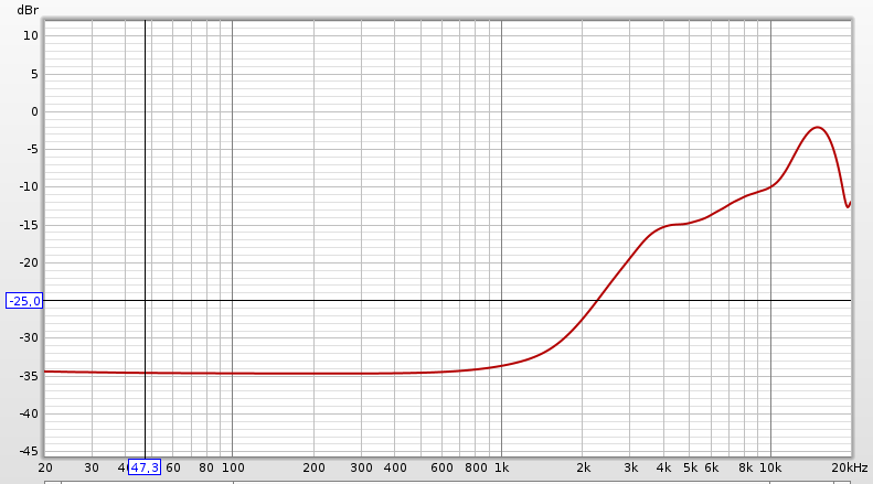

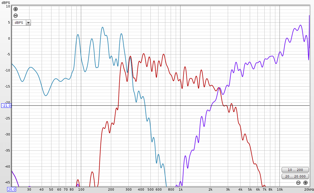

final crossover is a bit more than a single 8K filter! This is the crossover once convolved with room correction, I believe FIR filtering is the way to go :In total? Btw: an 8k filter 1t order 88ksps should be OK with say 4k taps.

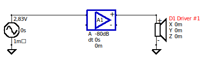

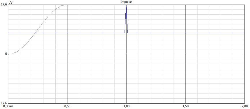

Thanks! Looks like something is wrong with IR export. Tried even more simpler:There are 4 ways of export in Vituixcad, but I am not very sure why results are so different.
On my previous image red is Driver SPL D1, green is Driver in D1 export.
IR export shows a Dirac which is good:

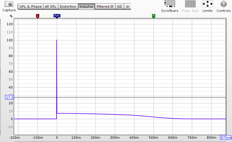

But once exported and imported in REW :
Looking at the impulse with a dBFS scale, it looks like a DC component is added somewhere in the export process :
