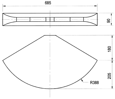

After 12 years I finished the woodwork of my Bruce V1.2 (from the old frugal-horns site) and I remembered I have on the shelf some Visaton speakers.
It is a set of the TL 16H HF horns and the DR45/MH300 MF horns.
Now when I bought these years ago I thought of making the TL 860 D monitors. But after building the Bruce I know my woodwork skills are not up to it to build the octogonal enclosure. And they are rather large for the apartment I live in. So I looked through the original TL book (dated 1987!) and saw the TL Monitor 473 D.
This is a rectangular boxed version with a single woofer using the DR45/MH300 and TL 16H.
But I cannot find any plans of it. Not on the Visaton site/forum and even google turns up nothing, not even a photo of those speakers. Does anyone has (a link to) the plans for these?

Given the date this will be a guessed TL, not a designed TL (design tools were not available). I would approach any TL not designed using a modeler with skepticism.
dave
Guess you would have to design a box.
Is interesting absolutely no photos of the 473-D
horn is 685mm wide. guessing the lower cabinet
was as wide as the Horn
What woofer would you use?
TIW 360- 8 or TIW 300- 8

Sorry, I´ve missed your request... But here you go, this is from Elrad Extra 4 from 1986, so you have a classic speaker there. Hope the drivers are still fine! If they were mine, I would consider a rebuiling of the crossover, especially replacing the L-pads... there´s of course no guarantee to make things "better".
Hope the scan makes sense... a bit difficult to scan those old magazines, don´t want to destroy them...
