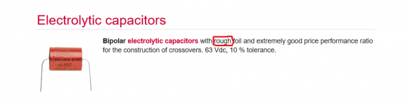

The capacitors are all horrible sounding, especially the black MKP ones. To me they sound grainy in the midrange. Resistors are like all others.
There is some logic in thinking that Visaton caps must be sounding "grainy" or whatever you want to call it. If they had make such a mistake with NPE caps, then it's probably not much better with higher end specimens.
