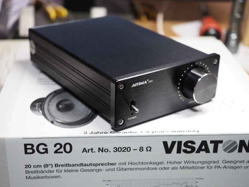

Can't I just use the finished product?
I am using Aiyima A07.
The power adapter is 33V, 4.1A and it is loud enough.

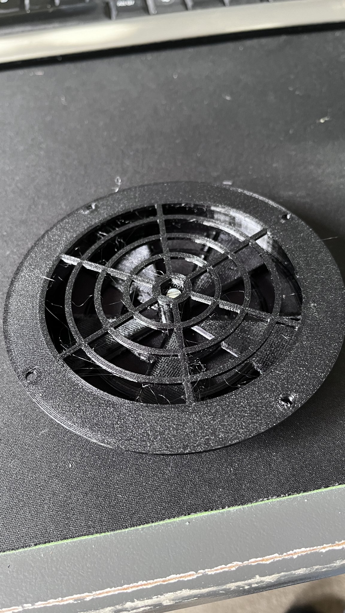

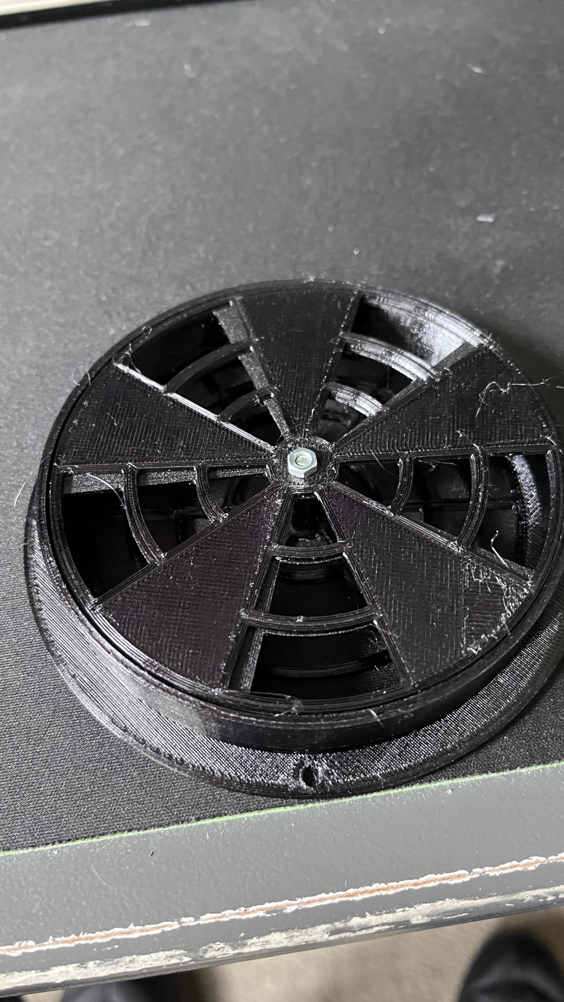

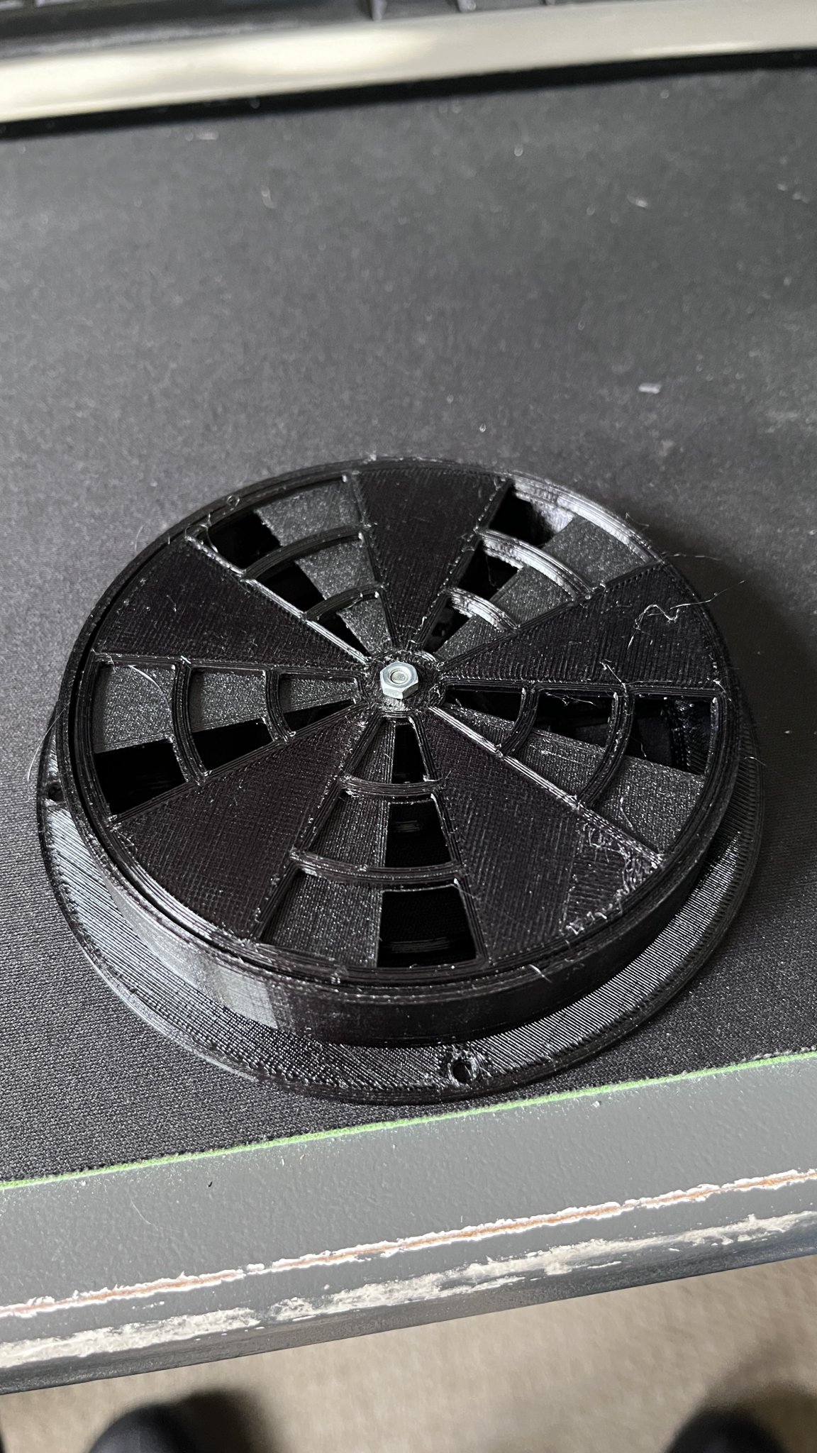

Thanks for explanation. So I’ve been looking at resistance vents and come up with a little 3d printed design for an adjustable vent. I can rotate the vent to increase or decrease the airflow, to test.
This will need some kind of poly filler, but I’m wondering about trying this first.
