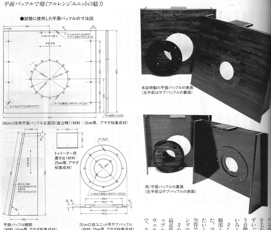

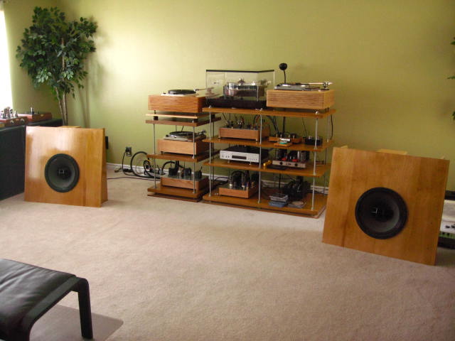

You can start with this easy and low cost open-baffle. (Some pictures found on the net, I don't remember where, sorry!)
I'm working with Visaton B200 and this open-baffle since two weeks. It is very, very instructive. You easily made many tries and understand how a speaker (really) works. Curves and math formula are not so instructive.

those look about 24" wide. that about right?

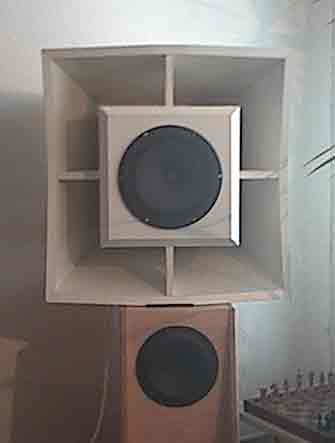

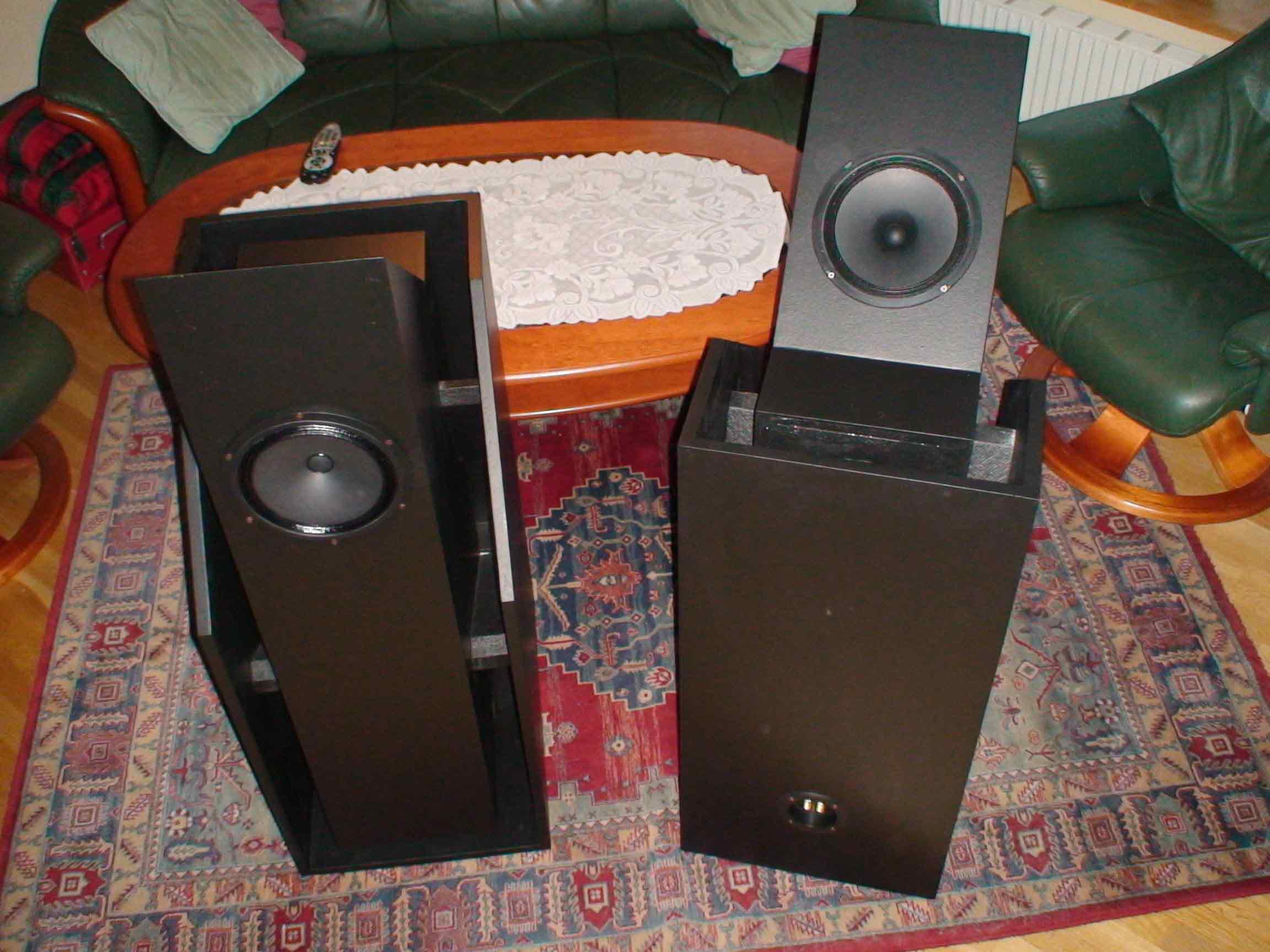

Hello,
i made a lot of positiv experience with the B200
for classic listener an superb driver.
I made a few satellite horns down to 100 Hz with 96-98 dB 1W1m
look my TRUMPET, HORN, SCHALMEI
a good sub is needed.
Or in my double horns with a second invers driver look my
SAXOPHON and the RDH20.
Most with feedback and measurements.
