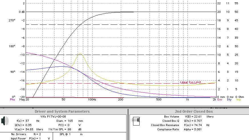

Ok here's me situation. I own 4 Vifa P17, which are 8 ohm, and the Vifa D27TG35, and my plan is to put them in a TMM config. in a 1 cubic foot box, about 30 liters, sealed. I'm sealing the box because I'm planing to roll off the Vifa's into a 10" Peerless at 300hz. But lets assume I don't have the Peeless yet. Also, I going to use a 3000hz x-over for the D27.
Here are my questions: 1: The specs for the P17's suggest a 30 liter vented box for one driver, what happens if I place two drivers within the same box, do I double the volume or will they behave as if they are the only driver in the box. I like tight bass and clear mids, should I vent or seal the box, based on the previous statement.

Q1:
Depending on the driver params, you will get a peak in some bass freq by halving the volume and rapid roll off thereof. It might sound boomy if used for bass. If used for midbass (with peerless) you are better off sealed because of better transient response.
Again unless you have the T/S for it, we cannot say exactly at which freqs will the peaks occur and roll-off thereof.
Q2: It will be 4 ohm.

Specs of P17
Here are the T/S of the P17
Specifications:* Power handling: 70 watts RMS/100 watts max * Voice coil diameter: 1-1/4" * Voice coil inductance: .55 mH * Nominal impedance: 8 ohms * DC resistance: 5.8 ohms * Frequency response: 37-5,000 Hz * Fs: 37 Hz * SPL: 88 dB 1W/1m * Vas: 1.23 cu. ft. * Qms: 1.55 * Qes: .45 * Qts: .35 * Xmax: 4.0mm *
And my plan is to find the perfect sealed box so that the mid-range is solid. I really just need the TMM to goto 300hz clean with no peaks. A zobel network might be used also, but for now I guess I would just like some suggestions on what size box to go with.

Thoughts
OK here is what I'm planing so far.
I will have a TMM config. in a 23L sealed box. The drivers should roll off at 75hz. I will no be using a zobel network since the imdence is just perfect when the P17's operate over 100hz. I guess I would like some help with a x-over then. The P17's will be in parallel so they will be 4 ohms and the Vifa D27TG35-06 is 6 ohms at 91 DB. There are so many different types of x-overs out there so if anyone has any good examples that would be great. I do plan on x-over at around 3000hz for the tweeter. This brings up two questions. Should I cross the P17's and the tweeter at the same frequency or should I put a gap in there. Also, if you put two woofers in the same box, does their sensitivy go up by 3db or 6db? If it goes up by 6 how do I messure the DC resitance of the speaker, there are in parallel, so does the resitance also drop? Thanks for your help

Re: Thoughts
That jives with what my modeler spits out....
XOs... can't help much there -- i avoid them. If i have to use one, i prefer either very simple or active.

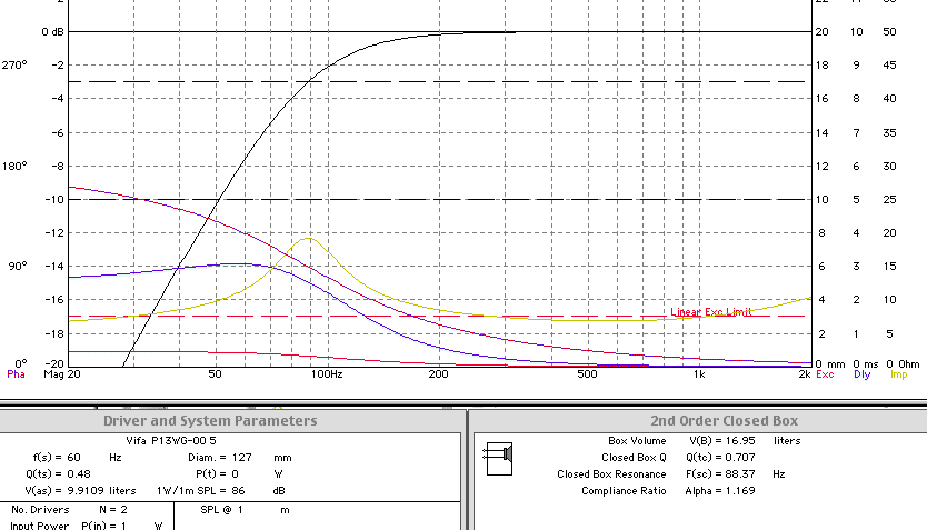

K-amps said:Nice pic... do you think you could do one for me, same box but using the P13WH (2 each)
K-amps said:Looks like a 200Hz XO would be in order for a relatively high SPL system.
If you are going to XO that high the P13MH might be a better choice... active XO at 200 Hz and let it run all the way up, bringing a T in at 4-5 k
PS: I read the spl of the P13Wh as 88db, and you have it at 86... does it matter? [/B]
Just the numbers that were in my database... doesn't affect the curve. The MH is also a bit more sensitive.

K-amps said:With an XT at the top end, I wanted to go with a 2.5 to 3.5k XO as I feel the Xt is a better driver than the P13 for that range... trade off right?
maybe, but there is a lot to be said for not having a complex XO "suck the life out of the music". Now if you were to tri-amp....
dave
