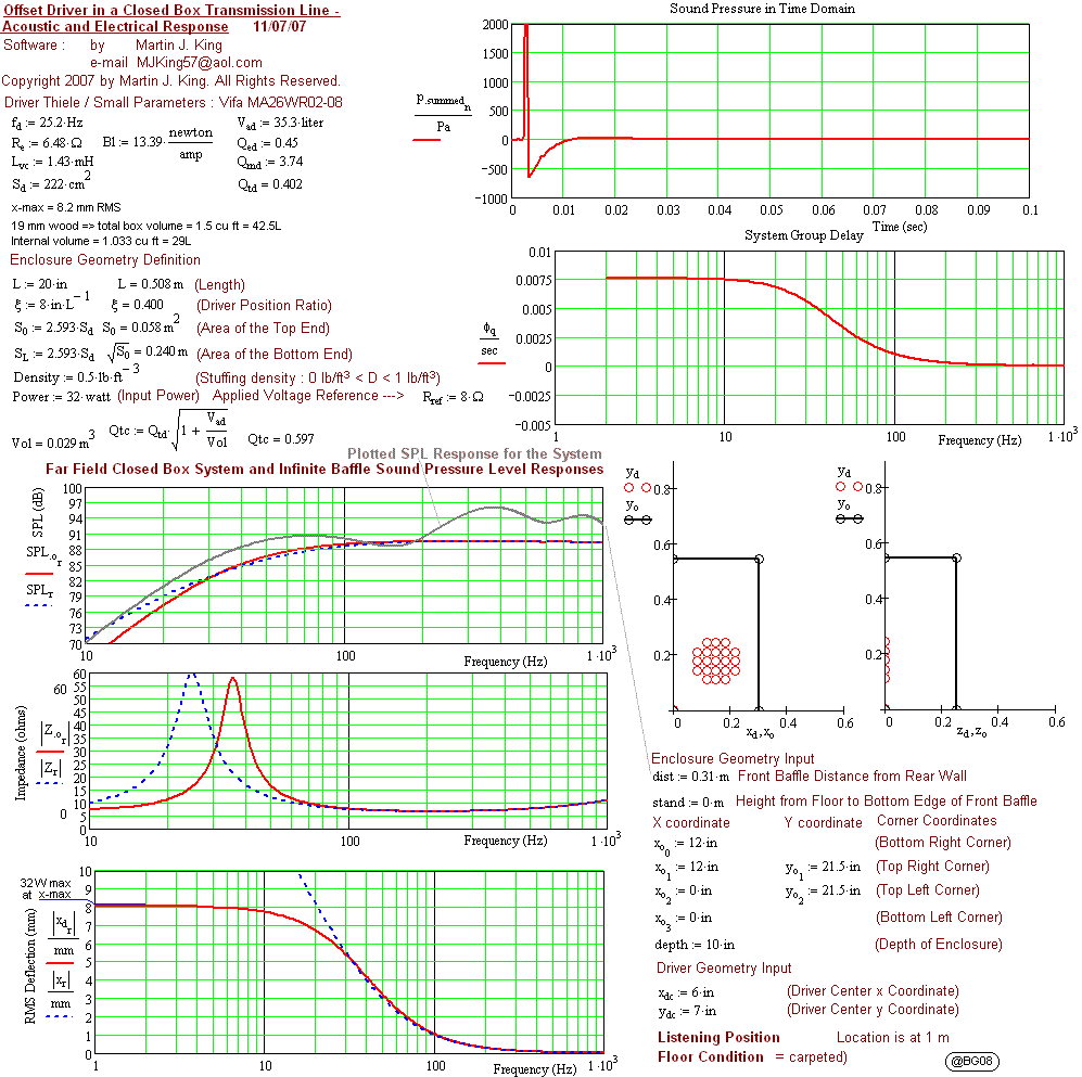

FYI: The Vifa MA26WR02-08 maximum safe input power for Ht or digital music without using a high-pass filter can be seen in picture: 1(1)
