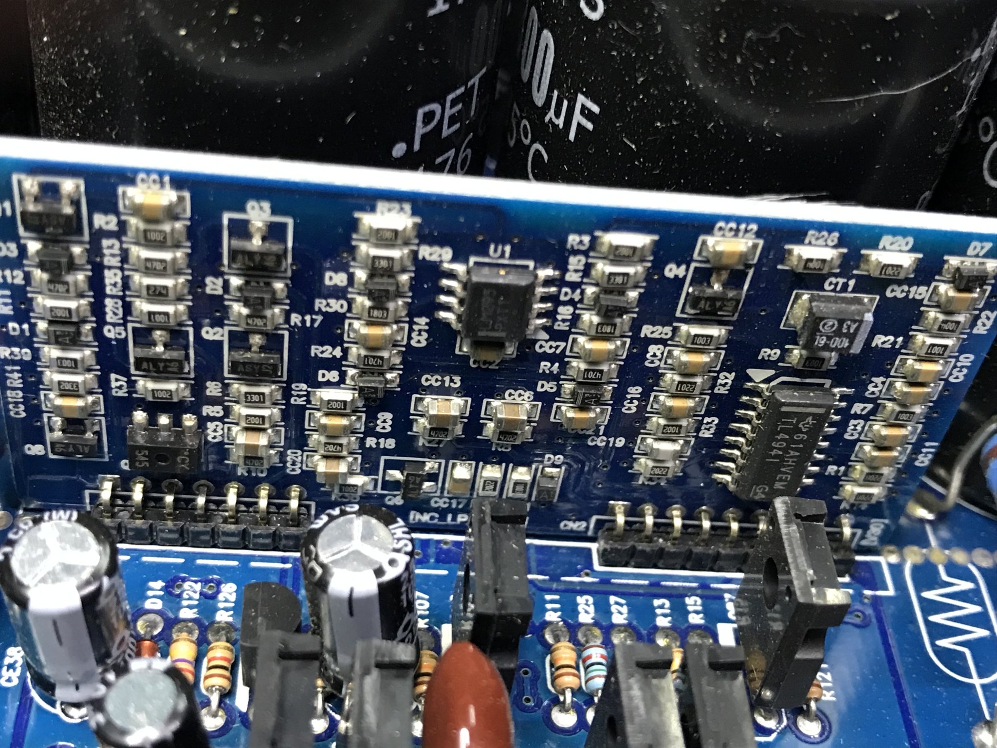

This amp is producing good audio but will go in protect if I try to turn up the gain or increase the input signal.It will protect when it reaches about half of its full power,

Was this amp working normally and then started doing this?
Post the DC voltage on all terminals of U6 on the audio driver board (black probe on the negative rail). Copy and paste the following list and fill in the blanks.

I got the amp in that condition.It looks like it has been repaired in the past but i am not sure if it was working properly after that repair.
Owner bought it used with that problem.
Pin 1: 8.56
Pin 2: 0.007

I don't see anything wrong with those numbers. I'd have expected pin 2 to be 0.000 but I don't think it's a problem.
If the PS isn't shutting down, I don't know which protection circuit could be causing the problem.
Does the output drop out at the input of the relays (on output of the output filter inductors) shut down when the amp goes into protect?
