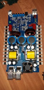

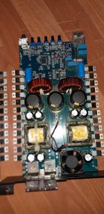

I'm dealing with the classic, usual Fullbridge amplifier Chinese copy of the Brazilian sounddigital.
It seems that there are various Chinese brands that copy them.
One in particular is really excellent and builds amplifiers for a handful of brands here in Italy, while others appear to be very poor, as they have (factory new) enormous and very annoying background hiss if used on the front speakers.
I've compared all 3 models (sounddigital, good Chinese brand and bad Chinese brand) and they really look the same, except for a few things, but they basically work the same.
The thing that immediately struck me are the output inductors, which are different between the 2 Chinese brands.
I'll try to attach 2 images of a good Chinese 5000 and a poor Chinese 5000, to show the "differences" that I struggle to find.

After doing all these USELESS tests, I'm seriously starting to think that the fault lies with the output inductors, which are literally terrible.
But I ask you, maybe someone has already understood something, and wants to help me.
As you can see from the photos, although all 3 are 5000w, the sounddigital and the good chinese copy, use only one power terminal block and a single output terminal block, also, the diodes are to220 format, while in the bad chinese copy, we have even 2 power terminal blocks, a double output terminal block and the diodes are in TO247 format.
The latter would be very favorable factors to a bad Chinese copy, if it weren't for the fact that, in practice, the amplifier is worthless.

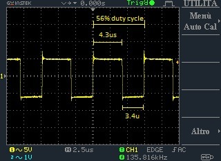

But from memory, I remember that the Carrier of that amplifier is about 112khz (khz more, khz less).
The bad Chinese copy has a carrier of about 145khz and the original sounddigital has a carrier of 102/104khz.
What I have been able to observe is that curiously, the soundigital and the good Chinese copy have a duty cycle (on the output switching frequency) equal to 50%, while the bad Chinese copy has a wider duty cycle, that is, observing the switching frequency with the oscilloscope, I find that the positive edge of the waveform lasts longer than the negative edge of the waveform.
Also, I forgot to check if the noise was visible on the oscilloscope, but I guess so.

Unfortunately, the good copy is no longer in my possession, as I handed it over to the customer after repairing it.

At this point, I would like to ask if a poorly designed inductor could also impact the duty cycle.

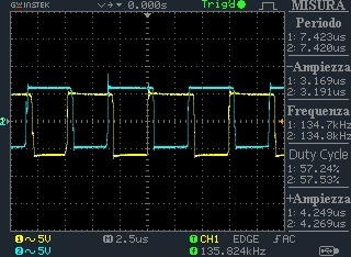

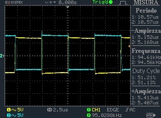

Hi Perry, In this picture I show you, you can observe the switching frequency of both half amps of an original sounddigital 5000 (which is how I expect it to be).
Then I made the measurement you asked me, and I was able to compare them also to the original sounddigital.
This is the situation:

You need to find the reason that the waveforms are offset. You know that they can't be in reality if they're swinging between ground and rail voltage.
For the chinese amp, Did adjusting the DC offset pot get the duty cycle to 50% for either or both of the carriers?

The waveforms are probably staggered due to the probes that are old and maybe mismatched, I've already bought new probes, but I still have to use them because I thought I'd use these until they died.
