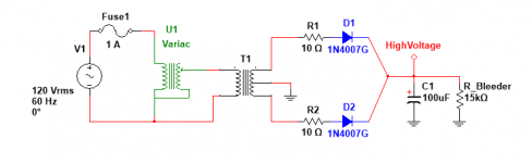

I need a variable 600v - 200mA HV supply.
I was reading a thread about this, but all models are too old or only in USA. Also, I see that some electrophoresis supply doesn't work properly (spikes, etc...).
I can build a power supply, but I don't know any project of any schematic.

You can make a very simple and useful HV supply with just a variac, an industrial PT (say 230V to 480V), a bridge rectifier and some filter caps. You don't really need a regulated PS for testing guitar amps...
Build a PSU with two sections fed from one secondary: cap input (DC out ~1.4 x secondary AC RMS), and choke input (DC out ~0.9 x secondary AC RMS). That gives you two voltage rails. I did this and have approx 200V and approx 300V to play with. You don't need more accuracy than that for playing with valve amps.
Regulated supplies are more difficult to design and build than audio amplifiers! And they introduce complications like reactive output impedance which can mess up the amplifier you are working on.

I use a Variac as jazbo8 suggests, but Variacs are pretty expensive outside the US. The great thing about a Variac is that you're not burning a lot of energy in the pass element.

I'm newbie and i need a recomendation for variac please. I don't find any variac whit 450 to 600V output.

These usually have taps on the winding at 0, 10%, 90% and max plus the wiper.
This allows wiring in clockwise direction or anticlockwise direction.
The 10% tap is ignored, leaving you with 0, 90% and 100%.
You can wire the mains into 0 and 100% and the wiper taps off any intermediate voltage upto 100% of the mains voltage.
Alternatively you wire the mains to the 0 and 90% and the wiper taps off the intermediate voltage and goes beyond the 90% tap to then give a maximum output of ~110% of the mains voltage.
This is very useful for testing mains powered equipment to the maximum mains supply of 253Vac, here in the UK.

That is, put a transformer after the variac to get a higher voltage.You can make a very simple and useful HV supply with just a variac, an industrial PT (say 230V to 480V), a bridge rectifier and some filter caps. You don't really need a regulated PS for testing guitar amps...

For the purpose of the thread initiator here's a simple Variac controlled HV supply. You use a separate transformer for the filaments.
