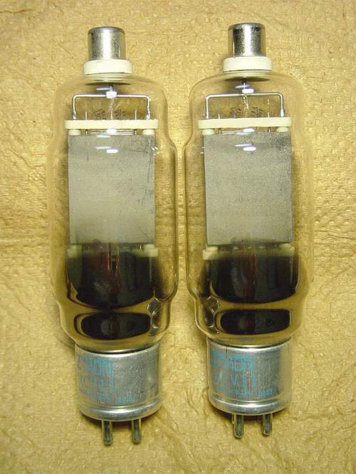

I have a pair of UXCV11 triode tube (Cetron) for SE Amp
but I have not the Data Sheet of UXCV11 Tube.
Where can I find data sheet.
looklike 813

UX-CV-11
Looks like it could be an interesting tube to play with. I have some in the UX base ones like you, as well as some with the jumbo 50 watt base (211 type).
I found out on the antiqueradios.com forums that they were used for diathermy. Pretty heavy grids designed to handle grid current.

Yes this number was used for diathermy apparatus and also some ultrasonic cleaner oscillator service. I have about a dozen of them but have never tried them for audio. Only small Tesla coils. 😀 Here is some info from Eddy R's site.

datasheet is here:
http://www.tubecollectors.org/united/archives/uxcv11.pdf
and more curves are on page 6 here:
http://frank.pocnet.net/other/UnitedElectronics/United_Elect_C59.pdf
