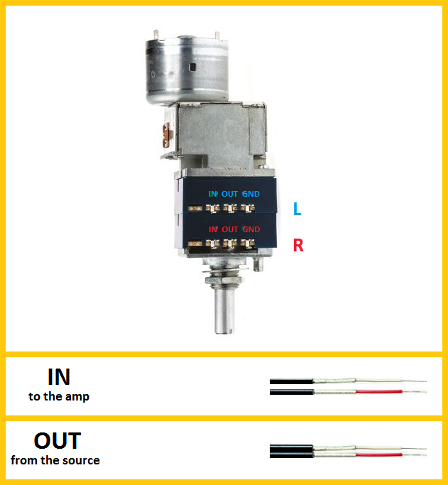

I want to use the power-amp section of my stereo integrated amplifier with a separate preamp.
Inside the integrated amplifier really are combined a stereo passive-preamp with a stereo power-amp.
The heart of the passive preamp is an ALPS Blue Velvet Stereo Motorized Potentiometer with its related IN/OUT/GND pins.
To the OUT pins (L & R) of the pot coming 2 shielded cables from RCA-socket inputs and from IN pins (L & R) of the pot start 2 shielded cables that go directly to the Power-amp stages (L & R) of the integrated-amp.
Now my question is the following:
Desoldering from the potentiometer the 2 shielded cables that go directly to the Power-amp stages and then soldering to their ends 2 RCA sockets (L & R) and then connect to those RCAs sockets the stereo signal coming from a different preamplifier should be a working way without issues?

Yes, that sounds right - do you know the sensitivity of the power amp though?

I would add a 100k resistor across each RCA input, just to be sure there's a DC path to ground for the amp input after the control is disconnected. Probably already is, but.
Please note that the impedance of existing potentiometer is 10KΩ.
So in your opinion a 10KΩ resistor could be enough?
It has to be soldered just as in the pic in attachment?

If your preamp/source can drive 10k properly, then a 10k resistor will be fine.
You can solder it mechanically however is easiest, but allow some strain relief length on the
resistor's leads, because the RCA inner conductor will move when connecting/disconnecting.

Following your advices I connected a separate preamp to the power stage of my integrated amp and it works like a charm: thank you both!

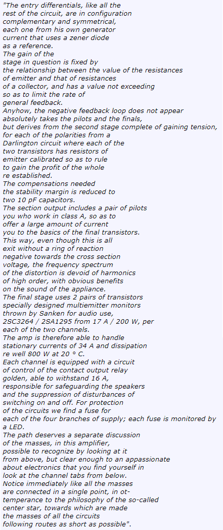

AMAudio T-90
Features translation (if useful in some way) in attachment.
