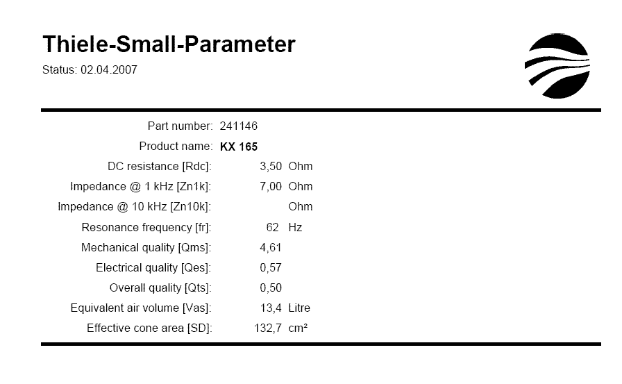

I have a set of Rainbow Audio SLX265 Deluxe, complete with crossovers and tweeters, just sitting around since I sold my Range Rover. They're + - 90dB 1w/1m, which is more than tolerable in a small little room.
Here's the link to the T/S,
http://car.rainbow-audio.de/files/dynamic/downloads/rainbow_tsp_woofers_en.pdf
I've ran it through winISD. they look nice in 50L floorstanders, down to about 60Hz, but my sub has taken over by this stage.
Running them from a 6V6 SE stereo amp I'm building

Maybe I'm blind, but I can't find the driver you're talking about in that list. A much better way is to do some work yourself, and post the actual specs, rather than point in the general direction.
It doesn't take much effort, and you ARE the one asking the question.
A simple screen capture will do...

my apologies. I was in a bit of a flurry earlier. Box plot looks good, -3dB point is at 70-ish hz, prime sub territory.
The slight peak at 80-150hz will be useful for rounding off the bottom end with the SE amp...at 1.5w/ch, they need all the help available...90dB ought to be plenty in a room
