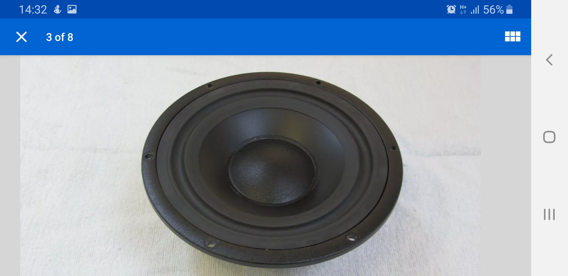

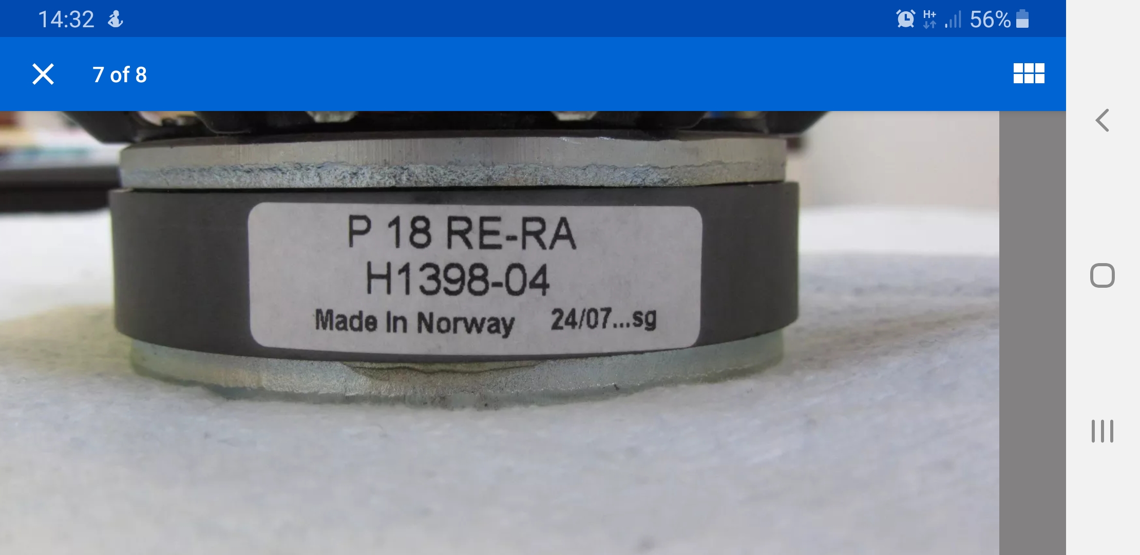

Won these cheap on Ebay. They are a proprietary design made by Seas for a speaker manufacturer that went bust unfortunately. I have no idea who.
They are very affordable at £26 per pair so I decided to take a punt.

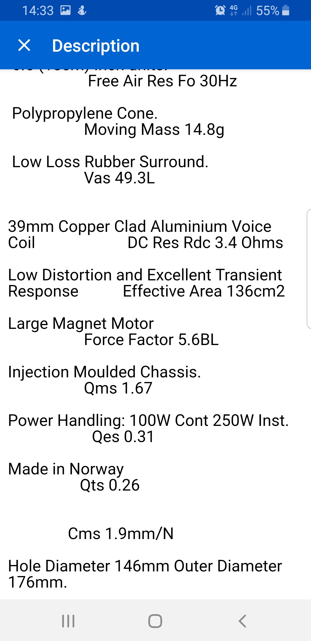

Do the specs lend themselves to anything obvious?
30Hz Fs could be handy for the lower octaves. Maybe cross to a 3" fullrange that I seem to like at the moment.?

Well specs are specs and any driver is going to have to be integrated into the system by the crossover. This driver's Qts indicates it should be used in a ported enclosure. Using a computer modeling program would give you a better idea of what designs would make optimum use of this driver.

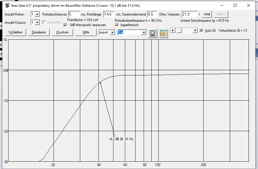

I have modelled in Winisd in a modest ported enclosure. I guess I was more asking towards the integration into the HF driver.
Quick general question.....what does the Fs tell us exactly?
An Fs of 30Hz doesn't necessarily mean it will produce that frequency? I see the impedance peak is at Fs. Should one avoid any port tuning near there.....or conversely....should one aim for there?

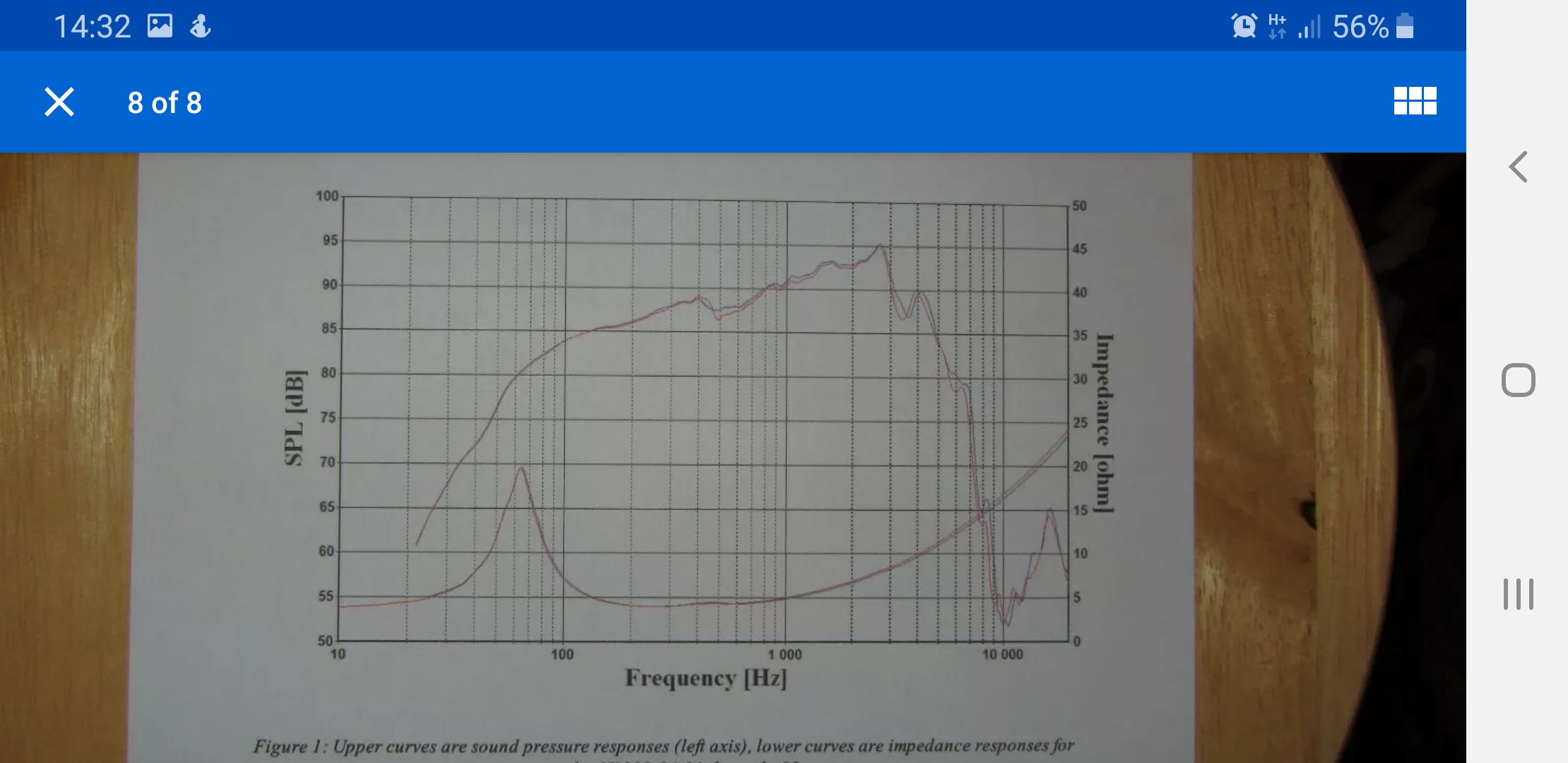

Wow, a classic RE with cone Whizard replaced by a textile dome, that interesting ...... but I would not call it coaxial ....
But it *is* a coaxial, there is a 26mm voice coil driver at the back of that magnet, complete with phase plug, short horn built inside the pole piece, and the main cone acting as a horn extension.
No whizzer anywhere and the textile dome is just a dustcap.
Just look at the response and impedance curves, the blue ones belong to the HF driver.
EDIT: sorry, I am referring to the speaker datasheet linked in post #2 .
Yes, the first one looks like the woofer component, but was never intended as a full range driver, never had a whizzer cone anyway, the dustcap is just that.

The driver in the link to the build maybe similar but doesn't have the same surround, mine have a reverse surround.
I had a reply from Seas to say they were for a company called Revolution Audio in Asia but are contractually bound to withhold the specs.
