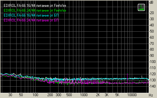

So, the Edirol uses CS5340 ADC and AK4385 DAC.
The E-MU 0404 uses AK5385A ADC and AK4396 DAC
The specs just looking at the datasheet shows what's theoretically possible.

Edirol FA66 (I cannot find my graphs for this one, but these are within +-0.2dB of what I remember, despite the sampling rate difference:
